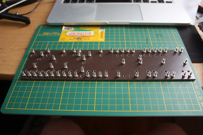

I'm almost ready to drill the turretboard and standoff holes. Just doing final checks on my layout to make sure.
- Posts: 58
- Joined: Thu Jul 23, 2015 7:28 am
Re: KT66 JTM45 / JMP50 hybrid?

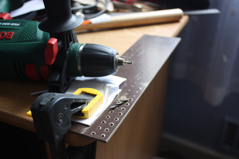

Checked the turretboard layout today, found a mistake. I'll check it once more before I take the drill out, tomorrow.
Layout with components
Drill Template
I'm actually going to start with 47nF caps in the output stage, despite what this picture suggests.
Soon...
I also want to see what the local elctronics shop has in the line of lugs I can attach to the can capacitor's legs, they don't have nice rings to solder to.
Drill Template
Soon...

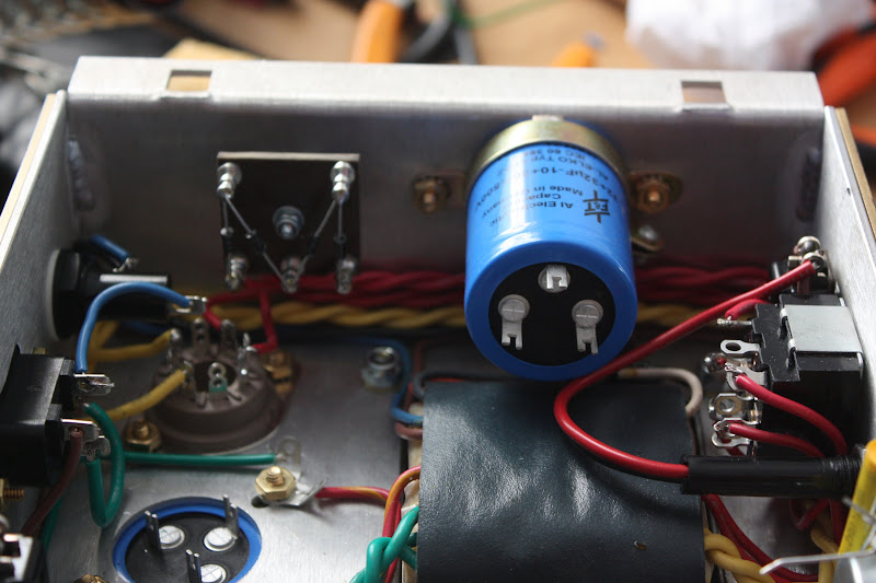

This was a lot of work. Flyleads in place, needs soldering.
Completed board
Checking whether the newly drilled standoff holes are ok.
Flyleads
I think it's going to look pretty nice though
Completed board
Flyleads

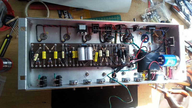

I'm close to done with this one. I can't believe some people build them in a day O_o I still need to solder the fly leads, attach them to the sockets, controls, add the 100k on v2, OT, choke and wire the cap cans and finish the wiring to the two mode switches and the NFB switch.RockinRocket wrote:Those faceplates came out really nice! Cant wait to see it finished and your thoughts on the switching. noise ect.
