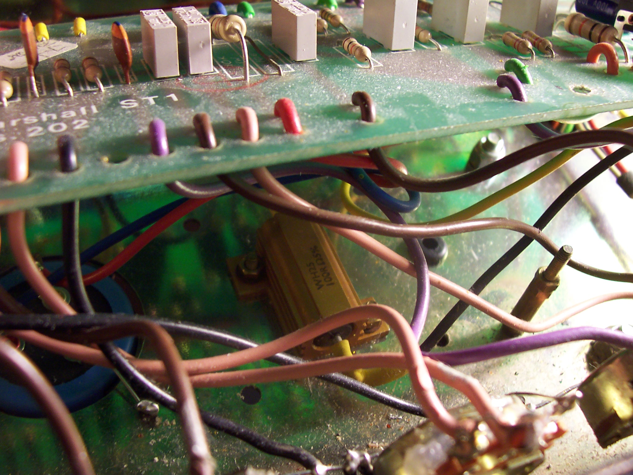

Hello.
Hope you can help me. I've got a '89s JTM45 Reissue amp. I bought it used some years ago. Now I really think about to upgrade my JTM45 at first with a Metroamp JTM 45 Retrograde Kit (+Sozo Mustards) and KT66 tubes.
I looked at the circuit diagrams and I found out, that my amp does not have a choke. I only can find a special resistor under my board (WH2.5 100R Ohms 5%) that is connected to the 10K/1W resistor near bias regulator and is also connected to 50uF/500V capacitor (see attachment).
What do you think: Does it make sense to remove the resistor and to integrate a Shinrock SCH-RS20H choke from Germany (I can't get a MM choke in Germany).
Thanx a lot for your help.
Regards,
Johannes
Regards,
Johannes
- Picture of resistor under circuit board
- (728.15 KiB) Downloaded 83 times

I'm not familiar with that particular RI, I'm guessing they used a resistor there instead of a choke to reduce the cost of the amp. The 100ohm resistor emulates the DC resistance of most chokes. It's cutting corners if you ask me and putting a choke in there will make it closer to an original. What you can expect if you make this change is more power supply regulation. This implies less 120Hz buzz in the output and a tighter response. It is a very cheap and easy change, so I would recommend you give it a try. If you like the loose response and a little more sag, feel free to experiment with a lower valued choke (7H or 10H).

At first thanx a lot for your help. For me JTM45 tuning is a totally new thing. Nice that you help such a german guy like me!wadeberglund wrote:I'm not familiar with that particular RI, I'm guessing they used a resistor there instead of a choke to reduce the cost of the amp. The 100ohm resistor emulates the DC resistance of most chokes. It's cutting corners if you ask me and putting a choke in there will make it closer to an original. What you can expect if you make this change is more power supply regulation. This implies less 60Hz buzz in the output and a tighter response. It is a very cheap and easy change, so I would recommend you give it a try. If you like the loose response and a little more sag, feel free to experiment with a lower valued choke (7H or 10H).
Oh, the resistor was stock. I thought it was made after buy. Very interesting.
You talked about 7H or 10H chokes. My english is not the best (response/sag?). Is it better to use a 20H choke to get the AC/DC Angus Young Powerage album rock sound out of the JTM45 or should I use a 7H/10H choke? What are the sound differences ? Hope you can explain it for me.

First, I'm not 100% sure that the resistor is stock. It looks like there are chassis holes drilled for mounting a choke and there is a hole/grommet for the leads to come through also. It may very well be that the previous owner wanted the 100 ohm resistor there instead. Chokes are a pretty cheap part, so it would be pretty weak for Marshall to not include one for cost reasons.
As for the value of the choke, let me say this: the power supply can either be described as 'hard' or 'soft'. A hard power supply is really tight, and a soft supply is loose. Sorry, those words are really subjective, but think about the difference between someone playing metal and someone playing blues. It all has to do with the feel of the amp and it is something you will be able to hear and feel in your playing once you can identify the style of power supply in an amp and how it responds when you play. The power supply on a JTM45 definitely drifts towards being a soft power supply because it has a tube rectifier and smaller filter caps. That being said, you would expect a smaller choke, but the typical value is 20H, which is high.
I would start with the stock 20H choke and see what you think. If the amp feels stiff, you may want to go lower. I'm not familiar at all with any mods Young might have done to his amps, but a stock JTM45 is an excellent start.

The Marshall JTM45RI that I attacked/modified was exactly the same as yours and was stock for that first series of RIs.
I used 16/16 and 32/32 filters and initially a 10H MM choke. I found it too hi-fi and too stiff with a MM OT and NOS GEC KT66s
I have since modded it again to JTM50 spec with different OT 3H choke and 32/32 and 32/32 filter cap and using Mullard xf4 EL34s - much better for me.
I suggest you get a stock Marshall 1987X choke (chassis is already drilled for it!) and lower the filter caps to 16/16 and 32/32.
I would use a Heyboer or Marstran OT.

Hi. Thanx for your answer.neikeel wrote:The Marshall JTM45RI that I attacked/modified was exactly the same as yours and was stock for that first series of RIs.
Just my 2 Euros
Are you also an AC/DC sound fanatic ?
I already have got a 1987x and I like that sound. It's more a AC/DC Live sound. But to get the studio "blues" sound of Angus which you can hear e.g. on the Powerage album I want to "tune" my JTM45. Does your JTM45 (JTM50 rebuilt) sound like that studio sound ?
At first I don't want to change the OT (output transformer), but the cheap choke. Do you really think a standard 1987x choke is better than a custom vintage 20H/10H/7H choke for the JTM45 to get the studio sound ? Where are the differences in sound ?

I think that the JTM50 (as per layout on the 50watter forum) is the nearest (using EL34s) although I have seen somewhere - probably here that he does use a KT66 powered 45 too. It has plenty of grind and 'gives it up' at sensible volumes too. Not as in your face as a metal panel 1987 (my gigging amp is a '76 tweaked to '72 spec (old trannies and different NFB, 1000pF bright cap and Metro PPIMV) not dissimilar to your 1987X.
For me the Marshall choke was cheap, off the shelf, fitted without hassle and does the job - when it comes to the OT I am much more picky .
