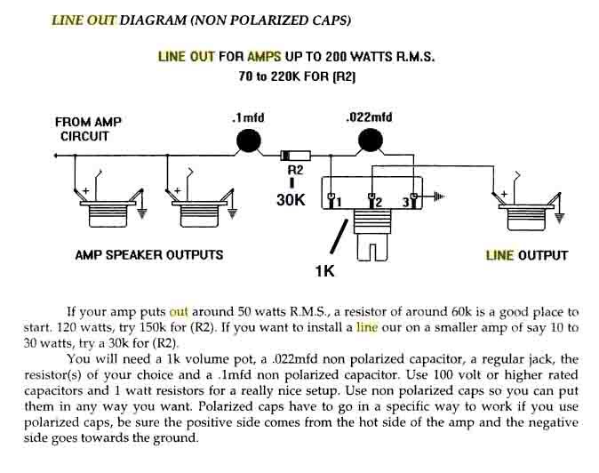

johnnybgoood
Posts: 115
Joined: Thu Feb 23, 2012 9:32 pm
Re: Slaving is quite damn awesome.
Post by johnnybgoood » Sun Dec 30, 2012 8:20 pm
There is another drawing for a line out box on the Grateful Dead Forum (http://www.rukind.com/forum/viewtopic.php?f=419&t=11321" onclick="window.open(this.href);return false;) for those who would like to build their own. It does not attenuate. It only taps a signal from the speaker cable. I built one to use with my 50 watt plexi quite some time ago. It cost me less than $10 in parts and it works great. On my line-out box, instead of the 30K resistor marked as R2, I used a 100K Pot in series with a 33K resistor so I could dial the tone of the signal to my liking. See attached pics and a direct link to the drawing below.
http://i240.photobucket.com/albums/ff19 ... ineout.jpg" onclick="window.open(this.href);return false;
line out 2
(48.38 KiB) Downloaded 717 times
line out 1
(51.76 KiB) Downloaded 717 times
catalin gramada
Posts: 182
Joined: Sun Feb 08, 2009 1:54 pm
Location: everywhere in Europe
Post by catalin gramada » Sun Dec 30, 2012 9:25 pm
you must try to keep the impedance into a decent range : 1-10 k will be pretty fine to acomodate any fx devices. the frequency compensation is debatable as you have not the same signal shape into the output line as in speaker , and anyhow can control that direct from fx tone control. better to use a good speaker simulator in front of fx chain. a good one can take the voltage direct from speaker output aso.
I use other the speaker output direct into a palmer adig through tc electronics m-one and a peavey solid state mono monitor amplifier. if you cab can be use in stereo configuration you can use two speaker for dry signal and two for wet.otherwise two separate cabs will be better
it is awesome indeed. better to mix acoustic signals instead to mix electric ones into a fx loop, no matter which.
