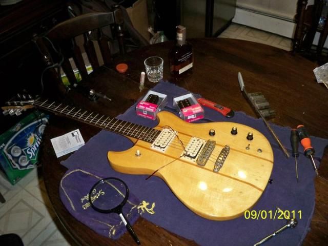

a couple shots of her right before surgery

here she is gutted

and here she is with the new hybrid duncans and wiring
I didn't take any pictures of the coil swap on the pickups, sorry didn't think to take any.
