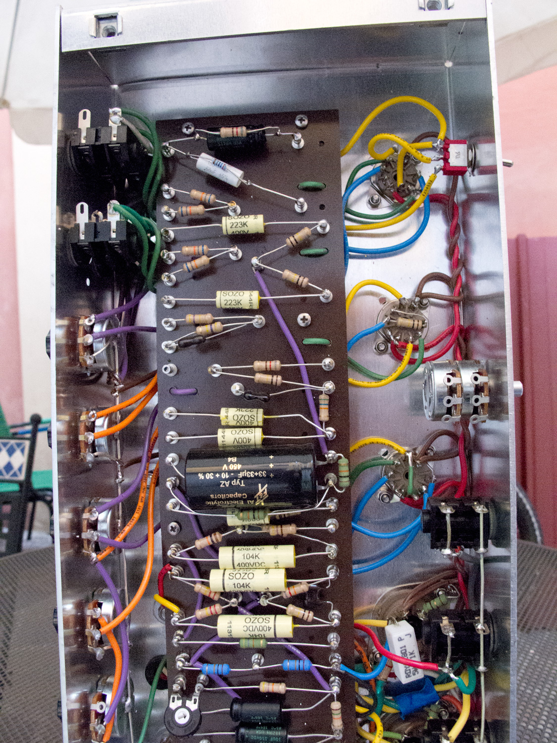

Hmm.. You have something going on in the area of the treble cap/slope area... You built a Fender!

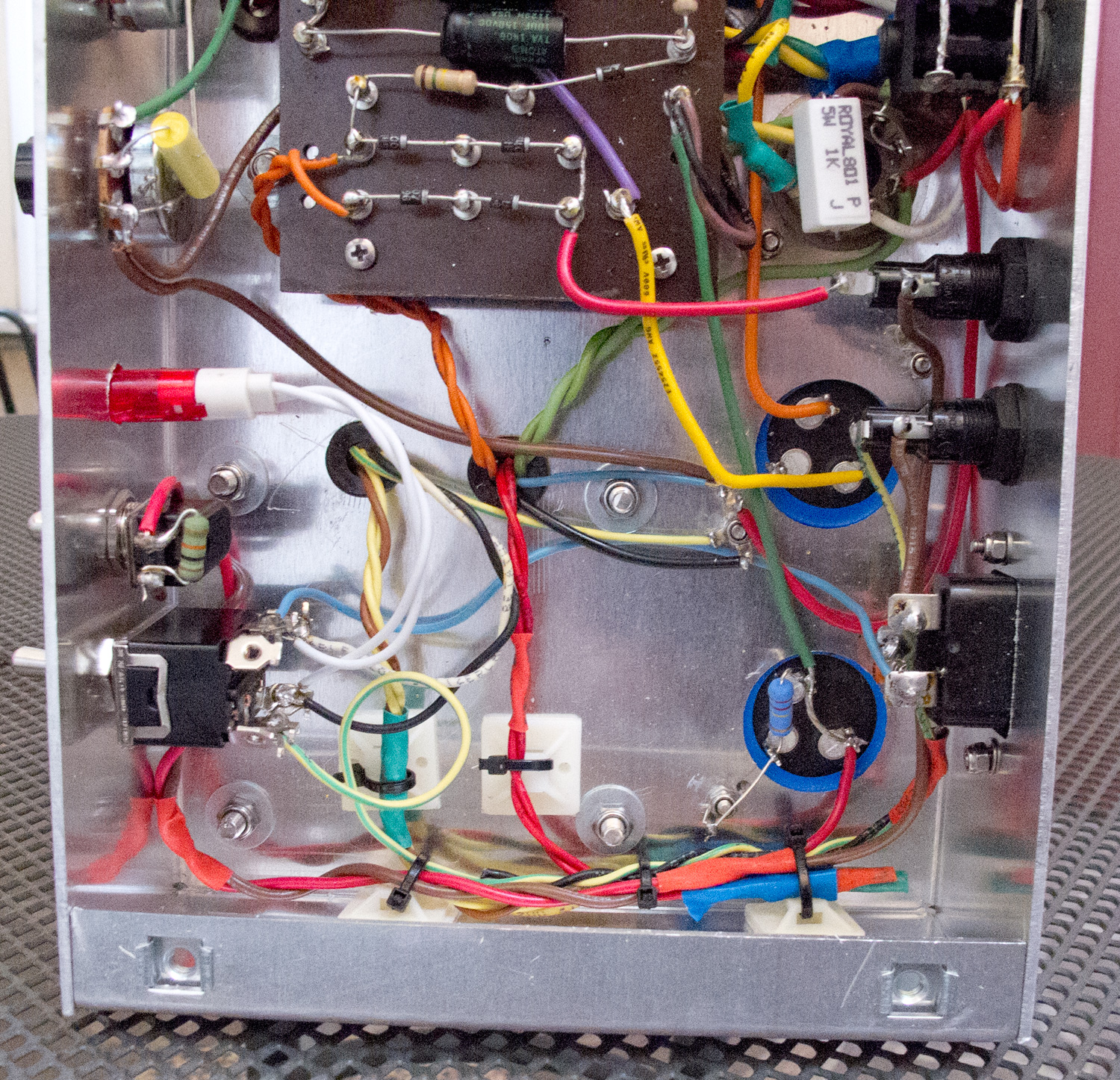

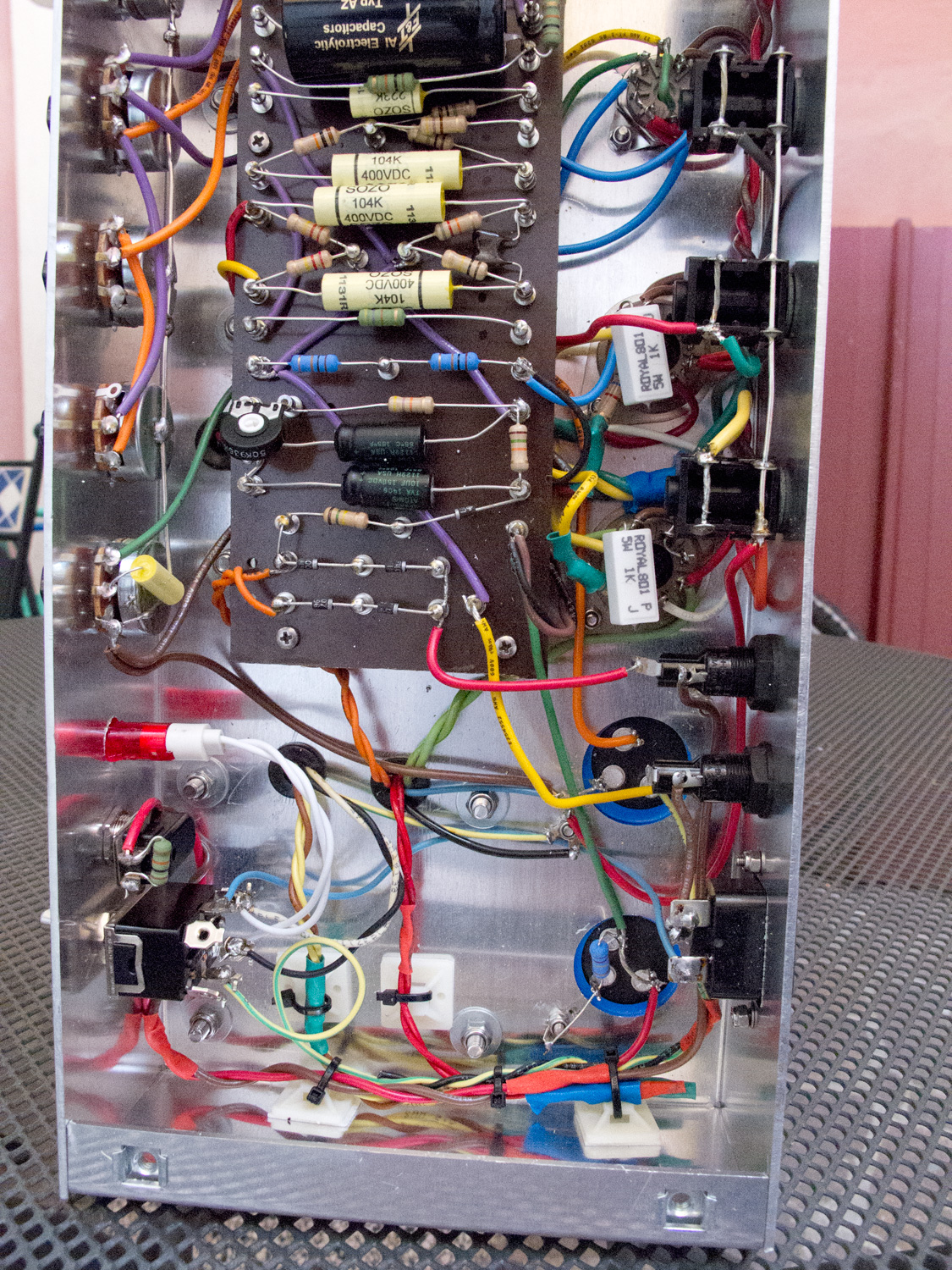

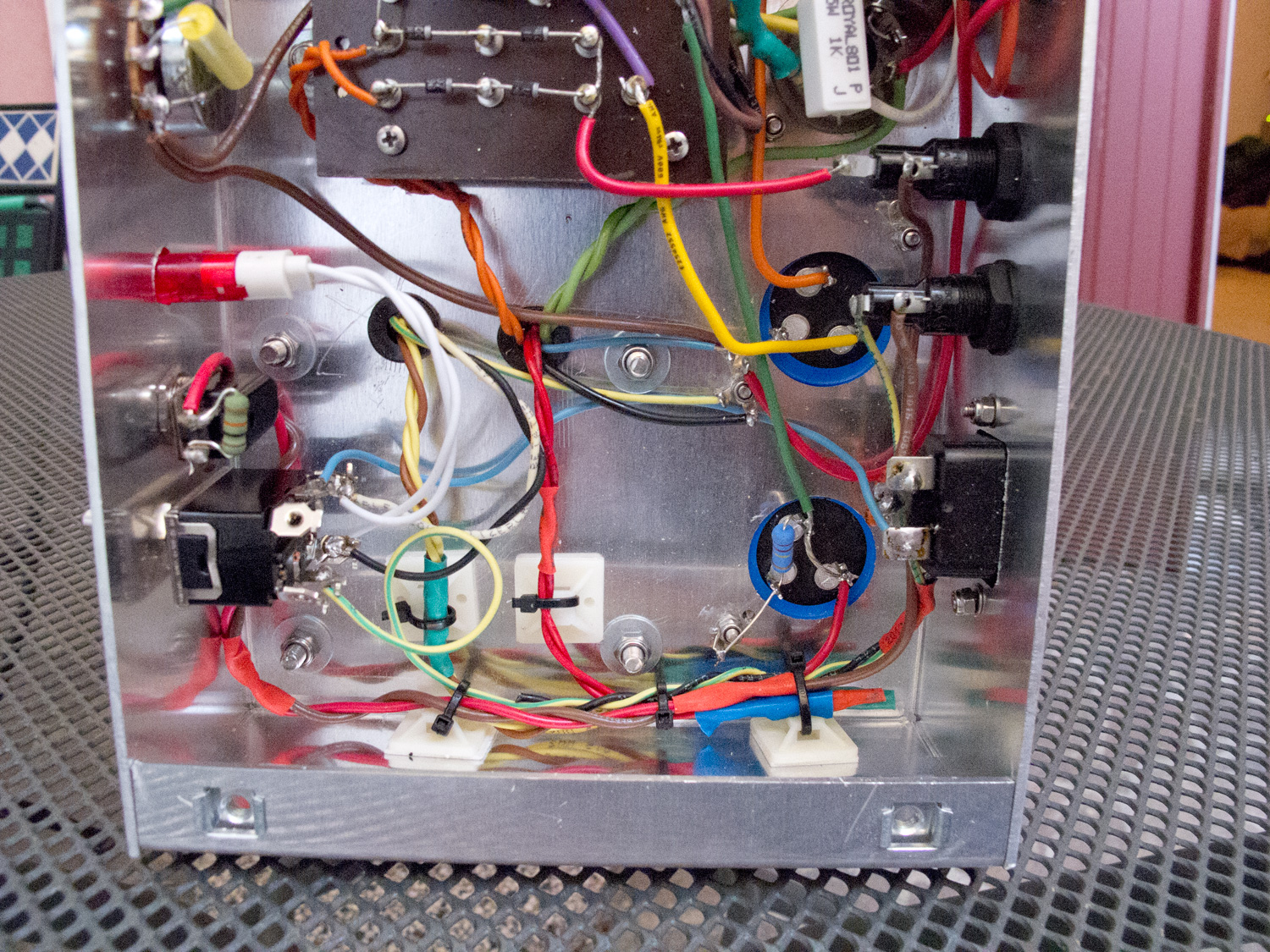

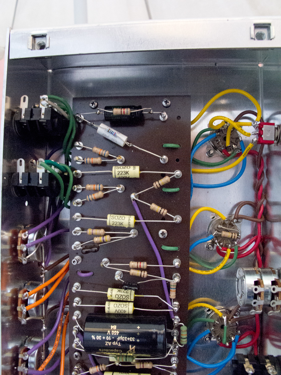

Bad practice all around the dress from the .. from everything. You need to get your input wires down to the deck instead of that stylish waving thing that is half a loop around and over. Look at one of George's amps (or Neil's) for perfection in dress.
All the lead from the pots should dive straight to the deck, route to where they go, then straight up to the junction. Anywhere you have a loop in a power creates a transmitter, any loops in signal are antennas.
The channels do affect each other. Your's will crosstalk more because of lead dress. With the tones at 0 you have around 12db average cut on signal, ballpark.
I'll give it another look when I get a few minutes here, but looks fair as I see it.

This is caused by the resistor you added across the standby switch. Is that resistor 10k? Are you trying to simulate lower voltage for a "brown sound" there? (if so, that's not a good way to do it)whitewave wrote:1. If I'm playing and switch off the standby switch, the sound becomes lo-fi and scratchy, as it should. The problem is that it lasts forever, the volume doesn't die as it is supposed to do. Even if I turn volume to zero, something it's still audible.
I'm not sure what you are attempting to do there but if you are trying to maintain some plate voltage to prevent "cathode poisoning" when in standby, you need a much larger resistor to reduce the delay in the "scratchy" sound and have no sound once the voltage drops (100k or higher, 2 Watts+).
Some volume rise and a pop noise is typical when switching power off while in play mode (not in standby).whitewave wrote:If I switch power switch to off position, the sound come back at full volume for something like 5 seconds, then it dies suddenly with a pop noise.
Some volume loss is natural, especially with the treble pot, but if you lose all volume, something isn't wired correctly (for a Marshall).whitewave wrote:2. If I turn the three tone pots and presence to 0 it loses much volume. This is normal?
That's normal for the type of presence pot you have.whitewave wrote:3. Presence pot is only one being a little bit scratchy.
Not normal!!! The unused channel's volume pot will affect gain and frequency response a little but you shouldn't get a "muffled sound".whitewave wrote:4. if I'm playing on ch 2 and turn volume on ch 1, where nothing is plugged into, I get a very muffled sound. Is it normal that ch1 volume interacts with ch1?
4.b the same happens if I'm plugged into ch2 and turn ch1 volume.
Loud pop noise is typical with that switch. (I'm not sure how to fix it but Neil's suggestion may work.) Turn the volumes down before switching.whitewave wrote:A split/shared cathode switch (the loud pop if I change it is normal?).
Lift your preamp and PI grid wires (V1-V3, pins 2 and 7) up away from other wires, especially the heaters to reduce noise.
Last, but not least.... purple wire is known to cause serious problems... Good luck!

The input jack wiring doesn't look that bad, but yeah, who knows what's going on under the board.Reeltarded wrote:...I am thinking dress is more than one of he issues, one of those being the crosstalk, no toner? Jist imagining what is there.

nothing in particular under the board, the wire just come out of the board the way you see them
