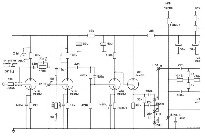

someone can explain me what does the 220pF over the 100k on #34 schem:
http://i1140.photobucket.com/albums/n57 ... 28c355.jpg
thanks

Post by herbvis » Sun Nov 06, 2016 3:58 pm
It rolls off some highs. Can be used to control oscillatins or for slight tone shaping.

may I ask also what does the 150k from gain pot to ground? it seem to me it interacts with the variable resistance of the pot changing it.. so with some setting of the pot it simulates a lower value pot (=warmer tone) while in others a higher one?
