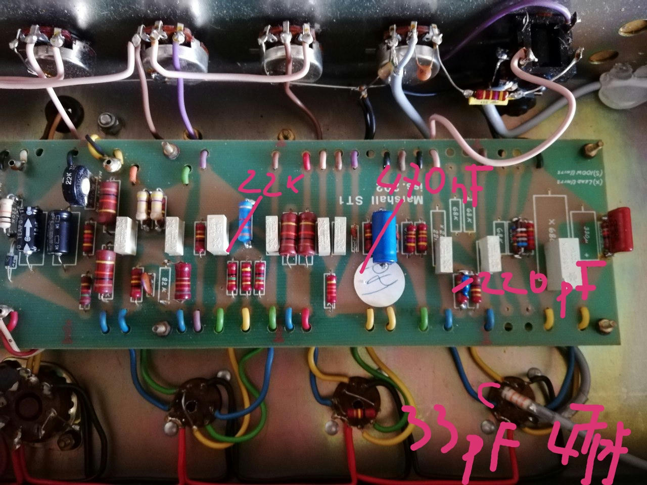

So this is what I should do, replace those 3 blue ones.
For the shielded cable I don't know what to do, but I will also try to add a 33pF or 47pF capacitor welded directly to the valve pin in this way as in the image above. I don't know who suggested it
You are correct on the 470nF cap and 22K resistor. The small blue cap bypassing the plate resistor may be the right value - 2kV is the voltage rating. The number under it should be 221 which is 220pF. It seems to be, but the pic is not 100%.
Small pF value caps from plate to grid, at the tube socket can be used, but the caps will put voltage on the input jack if they short circuit. You'd really need to put a blocking cap at the input to safely use those mods. 15pF to 47pF has been discussed, with 15pF to 22pF being preferred, IIRC.
So this little cap is used to replace the shield cable 'correct-but unsafe', to have the same effect?
in my case there is the shield cabl, but it's not correct being safe, right?

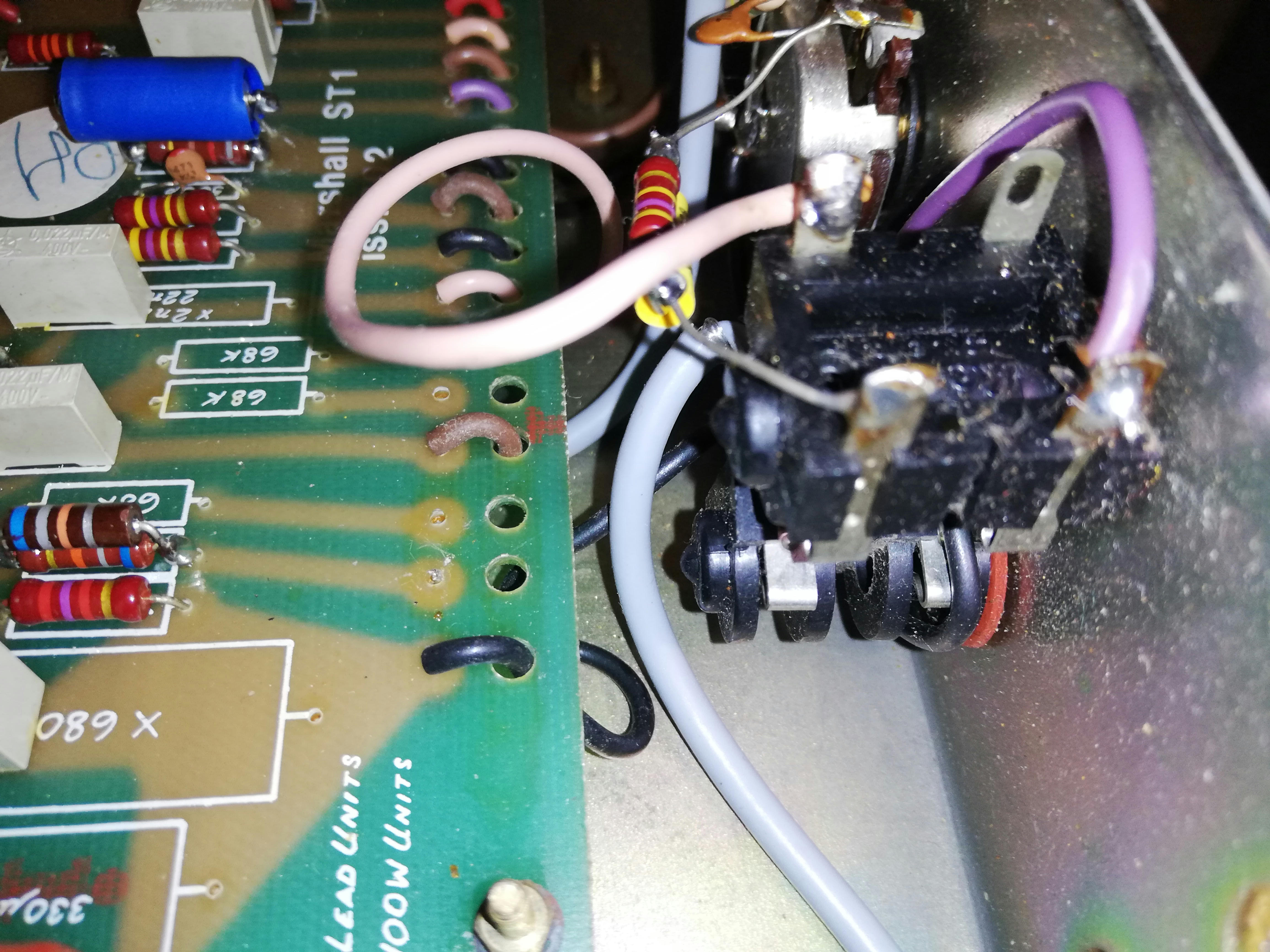

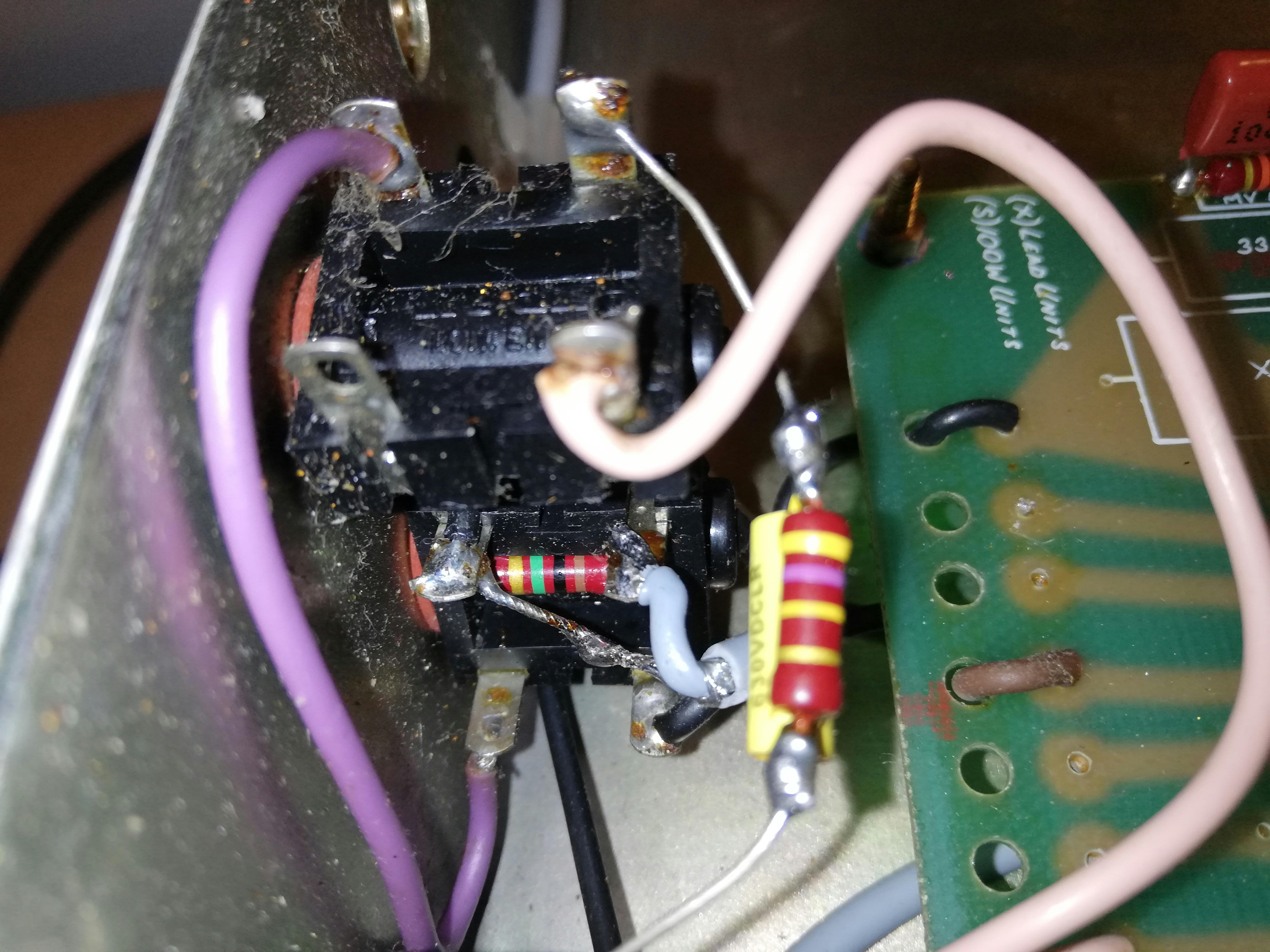

Yes, to get a similar effect as the hot shield. Your shielded wire is correct for most standard config, but not what #34 was shown to have.

next Thursday I will make these changes, so I could also change the shield cable to make it like in # 34 (although I don't know how to do it) or leave it like this and add only the little cap.

You can do whatever you feel safe with, but the cap from plate to grid is fine with a blocking cap at the input - those are not too hard to accomplish. IMO, the hot shield is not worth it. Most shielded cable of that size is not rated for proper voltage. It's harder to accomplish safely.

Excuse me CoffeeT this will be the last question :D
could you tell me if there is a precise value to buy for this blocking cap and where should I get it soldered to the input?
I should say what to do to the luthier, so I don't know if he knows it. They are generally not even technicians :D

Save this because I'll remove it soon. Use .22uF 400V to 630V rated cap. .1uF would work if need be. The 1M resistor must go from the cap's output to ground. https://scontent-atl3-1.xx.fbcdn.net/v/ ... e=5D86DE4F

Small pF cap would go from pin 6 to 7 not 6 to 8 as shown. I only re-drew the input jack wiring.

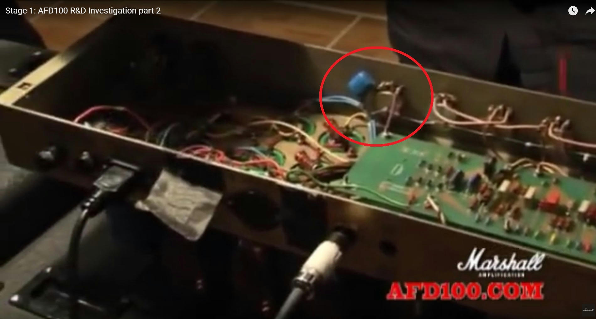

CoffeeTones wrote:
Mon Jun 10, 2019 1:09 pm
The #34, .1uF versus .68uF presence cap is debatable and there's more to that subject than I care to get into again. You are misleading by saying to remove the present pot mounted, 4k7 tail shunt / part of the negative feedback circuit. By doing that, he will not have a proper ground source for the PI and the negative feedback circuit will be incomplete. I see Santiago has the 25k pot wired as shunt on the schematic, but it must be an error. I'll have to dig up the pics.
I have not looked at the pics of the #34 original lately, but it may have had the 5k presence pot / circuit with .1uF or .68uF cap. That 5k pot is wired much differently than the 25k pot circuit, in which case the 5k pot is acting as the 4.7k tail shunt and part of the NFB ratio divider. Anyone building the mod should try both circuits and decide which is preferable for themselves. Check out the 68' Plexi and 2203 schematics or layouts to view the presence circuit differences described above.
I've seen another stock '84 JCM 800 2203, identical to #34 with the exact same big blue presence cap and it was indeed a .1uF. Santiago also confirmed this for me. Then I was able to locate one for myself through a friend.
As far as the resistor on the presence pot goes, I have clear enough pictures of #34's presence circuit and there is no resistor on the pot. I took mine off and presto, there was part of the sound I was missing. Yes, it is possible that #34 originally came with a 5k pot, but since Marshall had quit using those pots some years prior, I seriously doubt it is. Not only that, but with #34's presence pot you can see the old solder left behind on the back of the pot from where the resistor was removed. The sound of my amp after removing this resistor was the confirmation for me that what I see in the pics is true. My #34 modded amp is an '83 JCM 800 2203 that is about 4 months older than #34 and it did not come with a 5k pot and it was equipped with a .1uF presence cap as well. However, my original presence cap looked like what is in the pics above, the box type, and it was also tan in color. Other than that, my amp is identical to #34 in every way as well. The '84 JCM 800 2203 I looked at, did not have a 5k pot as it also had the 4k7 resistor on the pot with the same big blue .1uF presence cap that is in #34. So I'm pretty sure #34's presence cap is a stock .1uF. I tried a .68uF cap and it didn't quite sound right either. It sounded good, but not as correct as the .1uF. So I believe that with my amp and this other amp both having the same presence circuit, and that other amp coming with an identical big blue .1uF presence cap like what is in #34 as stock and a 4k7 resistor on the back of the pot, that this was enough for me to believe that #34's was no different.
I will admit this, we do not know if anything from AFD100 discovery video was staged, but according to Santiago, it was as everyone seen it. He is also adamant that the schematic was exactly as he saw it in the amp. If you look at the schematic, it doesn't show the resistor on the presence pot, but it also looks as if that part was cut off. The pot is listed as being a 25k pot. And with the pics I have of #34, there is definitely no resistor on the pot.
Another thing people have missed on the schematic is that the resistor on the hot-shield is at the input and not the socket. This is also clearly shown in the pics of #34's. You can clearly see the resistor at the input. With my amp, having the resistor at the input does make a difference in the sound compared to having it at the socket.

Unique, my main point is that simply taking the 4.7k out and not rewiring the 25k presence like the 5k circuit is not a technically sound idea. You refer to the Santiago schematic, so look at it again. The 25k circuit is shown to be configured as the 5k circuit (with a 25k pot), not the 25k circuit with only the 4.7k removed. You mentioned nothing about rewiring the 25k circuit, you said only remove the 4.7k. If you do not reconfigure the 25k circuit wiring to the 5k circuit, retaining the 25k pot, the PI and NFB will have issues. If you reconfigure the circuit to 5k spec with 25k pot, you will have properly grounded the PI and provided NFB, but you now have a 47k (total) tail and 25k instead of 4.7k (resistor)to 5k (pot) as NFB shunt, thereby altering the NFB ratio and PI cathode DC, among other things. I did not say it will not work if wired correctly. Your initial post suggested to wire it improperly. How is it wired in your clear pics of #34?
I didn't say which presence cap value was used as an absolute. If Santiago says it was definitely .1uF, so be it. He is probably the only person who would know at this point. I believe the investigation video of #34 was legitimate. Still, the .1uF vs .68uF is an open question for some people. I know .1uF is the only value that sounds right in #36. I have not done anything with #34 in a while now. I do not like the .68uF in most situations, but it sounds right in some amps such as the RT mod amps you'll find on youtube. #34 is a thinner sounding amp, so someone who wants to thicken the sound may prefer .68uF, although .22uF, .33uF and .47uF work much better depending on the pot value used.
I do wonder which resistor value was used at the PI output grids in #34. I don't recall the details of what that specific amp would have came stock with. That doesn't matter much because any value change could have been made.
How about posting the clear pics you have of #34. I don't see any reason not to at this point.
I am surprised that #34 gets such a great AFD tone in one of those vids. Of coarse Slash was playing but still, the amp was sounding right.

Are you talking about this?
where is the 4.7k resistance?
with zoom: https://www.mediafire.com/convkey/008b/ ... j2e7zg.jpg

That is one view. It's not clear enough to say. There appears to be something "brownish" with solder at the bottom, on the right side of the pot and it appears to be connected as the normal 25k circuit. The 4.7k resistor is most often soldered to the buss wire, not the back of the pot. That is where the components are usually mounted in the 25k circuit, but is not a very clear image. Santiago drew it as a 25k pot with the cap connected as in the 5k circuit, or it's a simple mistake in his schematic. One thing for sure, removing the 4.7k and leaving the cap connected as in the 25k circuit, is the wrong thing to do. It will affect aspects of the PI operation. Without the 4.7k and with improper wiring, the PI cathode has no proper ground because the presence cap, as connected in the 25k circuit, blocks the DC from ground. I repaired an amp with this mistake once. Before the repair, the PI voltages were all screwed up and it sounded like poo. Try it all three ways if you want to. Just let us know your thoughts afterward.
