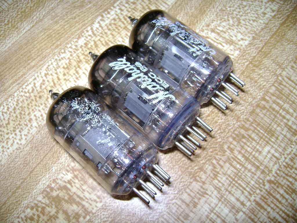

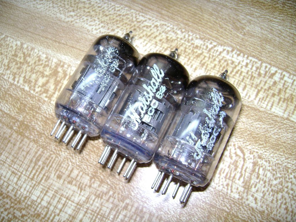

I believe I have over a dozen of these tubes. I'll have to check the getters to be sure. Not sure about the posts, but I remember they are dimpled, square foil and triple mica.

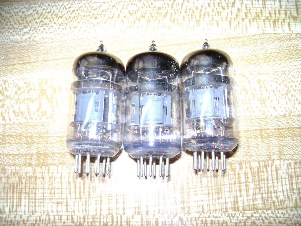

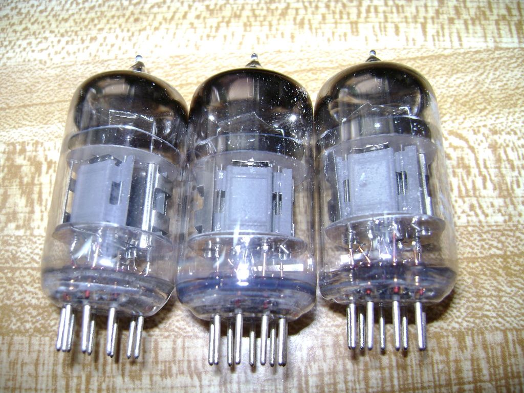

Post by CoffeeTones » Sat Mar 14, 2015 2:01 pm
Here are some I have. Looks like the ones.

Post by Unique » Sun Mar 15, 2015 5:07 pm
Yep, that's them, rebranded by Marshall. I have one of those that came in my amp also which I have completely forgot about. If you look on the bottom you should see either a "J", a smaller "JS", or something like that. Some of the J's I've noticed are hard to see, but held in the right light you can make them out.
