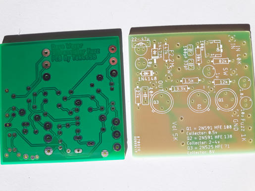

Ok the PCB are here and i am ready to ship :)
I have sent a PM to everyone who asked me for a PCB.(if i forgot someone send me a PM)
If anybody else want a PCB(2 left)
Send me a PM with your shipping address and email(to know where to ship and that it is your payment)
I will reply with the paypal address and rates.
Once payment is complete i will ship within 1-2 business day.
I will also make a webpage on my website for the complete assembly(including pictures) once i receive my parts in the mail.

I'm not sure I will be able to build and test the fuzz units for my European friends, but I will try to locate the transistors of the proper hfe and install them. I can also send a long some zeners to use to develop the proper DC bias for the input stage. (you have to try a few units to get the offset just right, in the center of the range shown on the schematic) I think the rest should be pretty easy. Xplorer has good access to most parts.

I did order some extra part and i will have one fully assembled and biased PCB with NPN AC127 transistor available for around 50$.
OR one fully assembled fuzz also with AC127 into a home etched enclosure for around 100$.(if my transistor stash let me)
Only downside is that i could not source a 1.8u and 2M pot from my supplier, so i ordered 2.2µ and 1M solder lug. Not a big deal for me, but if someone want one of my assembled kit they will have to source these 2 parts if they want exactly like the original(not hard to source).
Another option is that they can send me transistor/component to put in for them ;)

I went through my transistor stash.
I have 27 ac128. All under 15 HFe.......
I have about 6-8 AC127 around 70 HFe
1 Ac127 round 138 HFe, slighly leaky
2 Ac127 round 108 HFe, slighly leaky
Am checking online to buy a lot of suitable replacement and make a few matched set.
Edit: i just ordered a lot of 100 RFT GS109C PNP Ge transistor.

Yes i have 2 PCB i keep for you and shakti.
Contact me via pm for price chart(unassembled or assembled pcb and/or full kit). for now i cannot provide transistor.
Am waiting for the GS109C to come in the mail (*around 3 week) hope they will be over 100 HFe to make some matched sets.
In the meantime, i really hope Dave can find a huge pile of transistor for us :D
