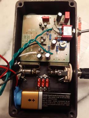

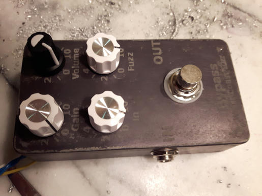

- Posts: 210
- Joined: Sat Jan 10, 2015 9:43 am
I spent the whole day sanding, cleaning, anodizing, toner transer, etching, drilling the enclose.(actually its my 3rd try so, i spend the last 3 day on this loll)
It need a good cleaning/buff but its how it looks like now.
It's not perfect but it's original
I could not fit the big 2Meg pot inside sadly :/
But am thinking of adding a wild mode switch that add a serie 1Meg resistor with the 1Meg gain potentiometer to have that extra wide range of gain.
Also, here is the drilling template/toner transfer for 1590B enclosure(will update/add it to my webpage later)
It is a Gimp file so you will probably need to download and install gimp:
http://www.mediafire.com/file/m4tfkp924fiofxz/fuzz.xcf

- Posts: 713
Great job Tek!!!!
You got it all inside. Well, the 2 meg pot came from a different era, when things were BIG. Easier for old guys to see.

- Posts: 210
Thanks,
What do you think about the wild mode switch that add a 1Meg resistor with the gain pot for a total of 2meg when maxed out?(its gonna do the same thing to me). I was also thinking of a 3 position switch that disconnect the FeedBack loop for a very wild mode
Yeah, its a bit of a tight fit in there, for people trying this in a 1590B enclosure make sure all the hole are well centered, there is no room for error.
In fact i don't know how i managed to insert a switch in there(the empty space on left side is for the transistor and i did NOT want to route the Feedback wires too far from the board).
