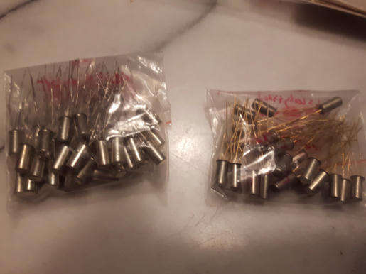

- Posts: 207
- Joined: Sat Jan 10, 2015 9:43 am
I love the changes you made to the bias circuit.
Am curious, why the 26V reed relay?(i guess part of another circuit).
Now to match the transistor you need a few of them. I looked around on ebay and there is some 2N525 and 2N591
Prroblem is they sell about 15-20$ each and to match/select the HFe, we need a group of them to make a selection.
I do have about 30ish AC127 in that same HFe range. They are the ones here on the right with the Gold legs:
http://www.mediafire.com/convkey/3a1b/9 ... 8tjc4g.jpg
Yes the one on the left are AC128 but they are all very low HFe, just good as diode.
So i can design a NPN version of the PCB(for 1950B and 125B enclosure), and provide some AC127(limited quantity) if that can help.
The PCB can still be used as PNP just reverse the Capacitor and power supply polarity.
TO1 and TO5 package are the same pinout if am right?.
Is that a good idea? Or make the PCB PNP(positive ground)?
Am ready to design/order a small batch of 5-10 pcb.
