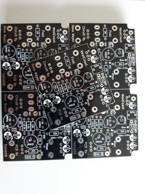

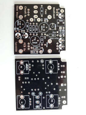

Allright, so the new batch of PCB are in!
I hope you like it.
Theres 38 in stock now.

Tek, really nice work!! They just look great, and it's especially amazing to see those original germanium devices sitting in there as if it were 1969. What I would have given to obtain circuit boards like that back in the day.
Wonderful job.
Wonderful job.
