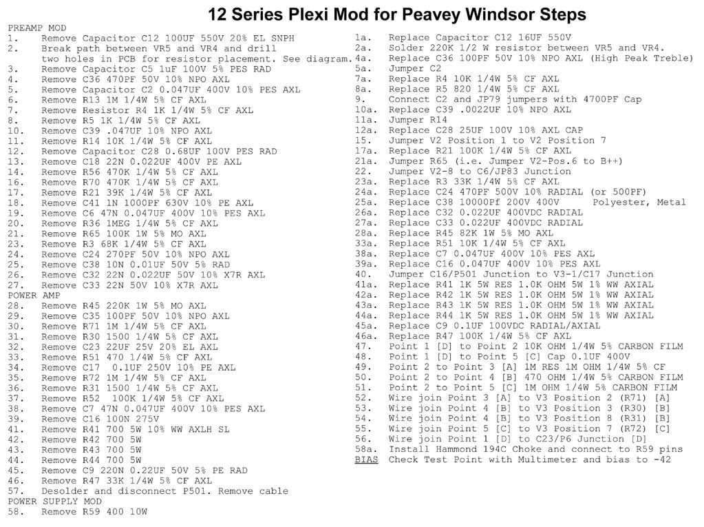

Here is a mod for the Peavey Windsor head. It works great. I got the idea after browsing all the mods located in the Van Halen section of this forum most notably the Mod 5 topics.
I noticed the screen cap change affects the sound of the amp in a very positive way. Replacing the screen cap with a 16uf value brings out the "wood" in the brownsound. This confirms it for me. Van Halen's original main plexi has a 16uf value in the screen caps (i.e. 32ufs in series) as well as Slash's JCM800 that he used to record UYI.
This mod will bring out your intestinal fortitude. The hardest part is drilling a couple of holes in the PCB board by the master volume pot to drop in and solder a 220K resistor.
Amp modding is dangerous work. Get your local guitar tech to apply this mod.

No one should be gouged big bucks for wanting awesome tone out of their amp.

This might be usefull to some of you...
I came up with a way to turn the cathodine phase inverter and its driver stage into a long tailed pair that doesn't require the use of a terminal strip.
I've put the required values of the components and erased the ones that need to be removed.
Don't forget to lift B++ ground Jumper!!
While you are at it you might want to replace the grid stopers (R32,33,34,35) with 1k5 or 5k6 and the screen grid resistors (R41,41,43,44) with 1k or 1k5 (3W).

So how did this work out? Any improvement on the tone? 100% safe? I'm getting ready to tear into my Windsor head.

Well, I think the Windsor is probably the worst JCM800 wanna be that ever existed. The circuit is just ugly and wrong in so many ways that is hard for me to understand how some one would even think such a circuit was a "good idea".
Having said that, it's a modder's dream. The PCB's have plenty of space and are quite easy to "read" even if you don't have an schematic. It's very sturdy and even though the tube socket's are PCB mounted it just feels reliable. More than both my Triaxis and 20/20 poweramp. I shit my pants every time I have to swap tubes on those filmsy pieces of expensive crap.
What I've done to my Windsor is basically convert it to a JCM800 and used one of the relays to switch in and out the second gain stage. I turned the cathodine phase inverter into a proper long tailed pair as shown on my previous post. It now has a Larmar MV and a 5k presence pot instead of the stock 10k. I also added the bias resistors so I can bias that thing correctly.

If you drain the caps there's nothing to worry about. The actual mods are not dangerous to the amp if that's what you're asking.loud and dirty wrote:100% safe?
It depends on what you are after. I wanted an 800 and I got it in spades.loud and dirty wrote:Any improvement on the tone?
What do you want to get from it?
If you decide to mod yours feel free to ask as many questions as you want, I'll be glad to help.loud and dirty wrote:I'm getting ready to tear into my Windsor head.

What's the deal with that bright green jumper line?

So, where is the b++ jumper and is it necessary to pull it if you converted the phase inverter to a long tailed pair on a terminal strip? I've noticed that when I did the long tailed pair p/I mod I lost a lot of volume. Would this remedy that volune Loss? Thanks for any help.inkomodo.dragon wrote: ↑Fri Jun 15, 2012 9:38 amThis might be usefull to some of you...
