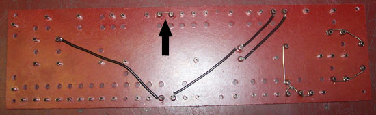

Post by VelvetGeorge » Tue Jan 25, 2005 4:25 pm
Just to be sure, do you have this buss wire installed between the two 10K resistor terminals?
George
000_0041 copy.jpg (38.5 KiB) Viewed 1945 times

Post by Flames1950 » Tue Jan 25, 2005 7:10 pm
I got excited about finding something amiss and glossed over the post about having 192VDC at the bottom end of that 10K and nothing at the top going to your tube. (You'll need the jumper anyway.)
Are you sure the resistor at that spot is a 10K, and not a 100K or 1meg? I'll confess that my eyes can barely tell the difference between the third band being orange for the 10K or yellow for the 100K, I've inserted the wrong ones many times without noticing until it's too late!! The 1meg would be a green band and that should be noticeable. Make sure it's a 10K, the bands should be brown, black, orange (and a fourth tolerance band.) If it's the right resistor go through the solder joints at the end orf the resistor and the tube connections I had you check to make sure you've got contact. We know there's voltage up to this point, so there's something right here stopping it. (You might try lowering the range of the voltmeter to see if there is a very small voltage present since you're showing zero, but don't forget to bump it back to 1000VDC when we get moving again!!)
You can also put one lead on one end of the resistor, and the other lead on the other end of the resistor. This will show you how much voltage is being "dropped" across that resistor, and it definitely should NOT be the full 192VDC!!
Flames1950
Posts: 9294
Joined: Sun Feb 08, 2004 1:04 am
Location: Waukee, Iowa
Post by Flames1950 » Tue Jan 25, 2005 7:14 pm
I double checked your pics but I can't tell if the color bands on that resistor are correct or not.
Something else that's been wearing on my mind is that if the Park did not have the pin 1 to pin 7 jumper, the Park preamp is not arranged the same as the Marshall, and we may have wires out of place for the Marshall circuit on these first two preamp sockets. If you can get another pic detailing the preamp tube sockets and that end of the board ready to go we may need it.

Hey dude, most of the preamp wiring looks like it's going where it needs to be. If you've added that jumper and changed out the 100K for a 10K there's only one other thing I see that's obvious.
Right now one half of you first 12AX7 tube is not hooked to a cathode resistor/cap. If you're plugging into either input of the I (Bright) channel you're not going to hear anything. Since it looks like you were going for the Bass circuit (I wasn't sure from your earlier post if it was the board or the head that was a Bass) move the second yellow wire from the left (looking at the head like your pics of course) over and connect it to the same spot as the first yellow wire, off the 820ohm/330uF resistor/cap combo. Bass amps are a shared cathode circuit, so both the yellow cathode wires will come off the same point. Although if it's a Bass circuit the coupling caps to the power amp are a little small.....if it's a Lead circuit you're missing a 2.7K and a .68uF cap for that spot.
I can"draw" on your pic to show this better if the description isn't enough, and either e-mail it or reduce it in size and post it here. I'm just running behind tonight, it was my Grandma's 103rd birthday so the family was at the nursing home for dinner. Otherwise I'd have gone ahead and done it already.
