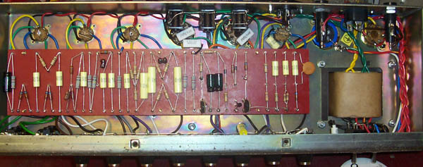

Post by VelvetGeorge » Thu Jul 15, 2004 2:24 am
Bluesbreaker reissue PTP board, take two.
I just finished this up about 2AM and I'll fire it up in the morning. This trem circuit should be better. Fingers crossed......

Post by Chutler » Sat Jul 17, 2004 5:56 pm
VelvetGeorge wrote:Bluesbreaker reissue PTP board, take two.
So how does she sound?

Post by VelvetGeorge » Tue Jul 20, 2004 6:08 pm
Well, that amp shipped out today. I had to tweak some values in the tremelo circuit to make it even usable. Not great, but it does properly.
It will take a few weeks to get the documentation together for a kit. But I know you guys are eager, so.....
if you're willing to build one of these with only detailed pictures of the board and install provided, come and get 'em.
I'm still working out the priceing. Email me if you're interested.
