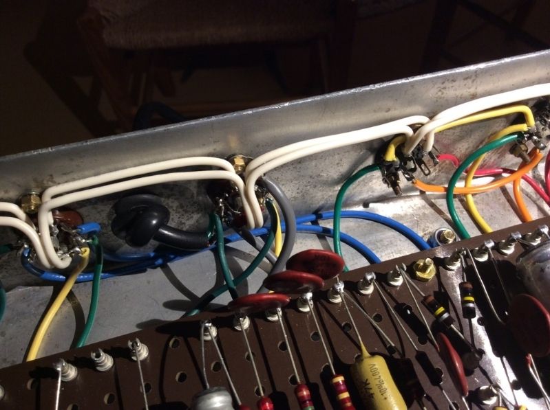

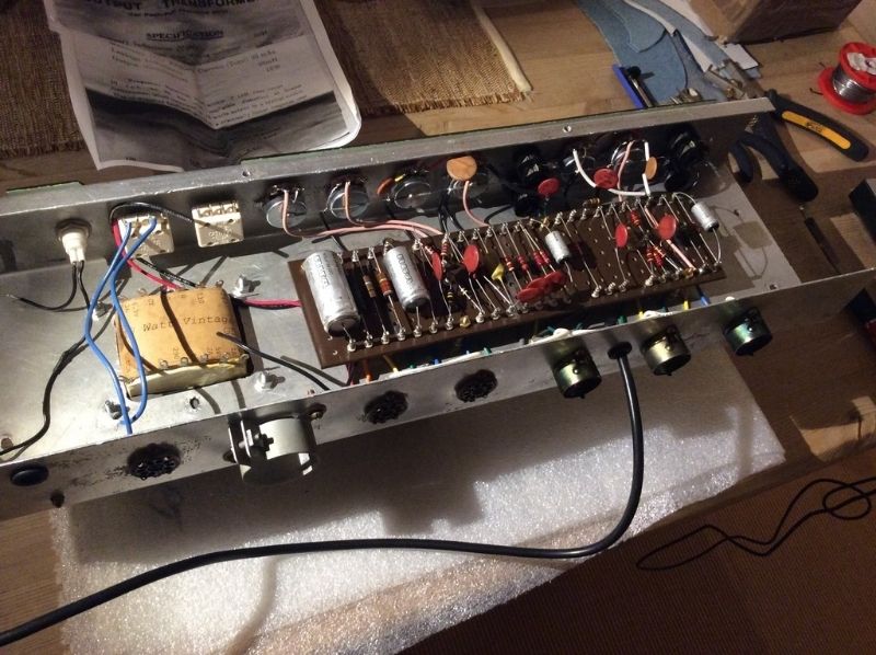

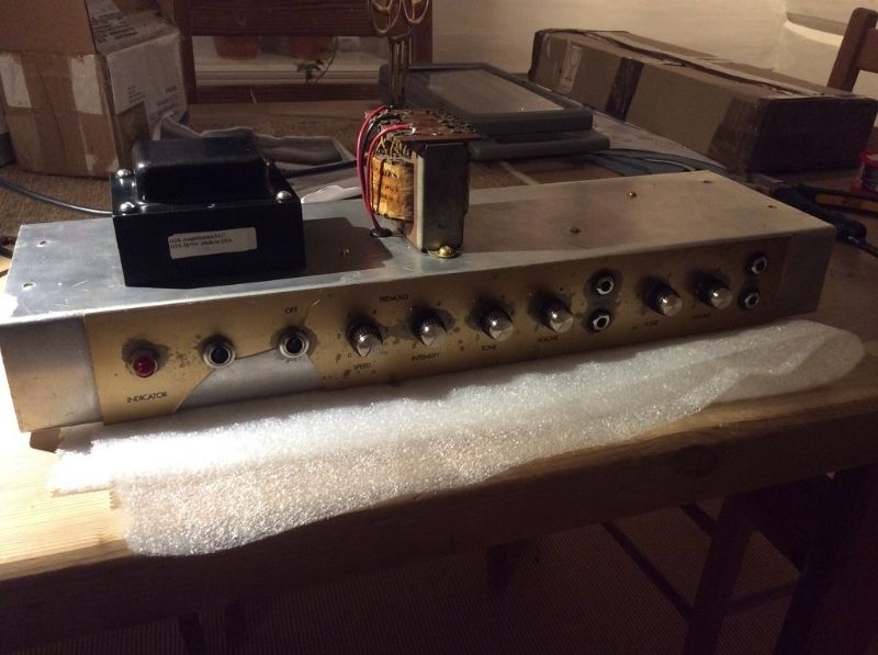

Getting very close now! I am trying to make this one look "vintage" and have tried to keep a little more "slop" in there than I usually do, but a few tweaks have found their way in, such as using shielded wire on V2 per Neil's recommendation.

Unfortunately, I got the classic phase reversal howl on first fire-up. I swapped the primaries over, but to my dismay I got the same howl. Any ideas?
The secondary of the OT is not grounded. I couldn't see that the originals had any ground connection on the secondary. OTOH, I would think it needs to be grounded just like we ground the common connection on a self-lead OT via the speaker jack. Do any of you 18w builders know?

I am still waiting for one 68k input resistor for the trem channel, so that one is not working properly yet. The normal channel, however, works exactly as it should with no squeeling, and glorious, touch-sensitive tone! There is a tiny amount of ground hum at extreme volume settings, but not too bad. Nevertheless, more hum than I am used to in my other builds where I use Larry grounding. I stuck with the standard grounding scheme for this amp, but grounded the heater CT on the ground buss on the back of the pots. I did not use shielded wire for the normal channel inputs.

The stock grounding on these does work assuming all connections are clean and good with tight nuts on 'cutting' ground lugs,
My 18w is pretty quiet. Getting the trem channel stable was the only issue I had.

No time yet to work on it, but I did notice one thing on your build Neil. I am certain it is not the cause of my current noise, as it was not there before I wired it into the combo cab. But I have the transformer screen and HV CT grounded along with the mains filter cap. Heater CT is grounded on the buss bar. On your build, Neil, you have the screen (violet wire) grounded to the buss bar, and the HV CT and heater CT both grounded along with the mains filter cap.
I don't really know what the transformer screen does and where it is best to ground it, but I chose to wire the heater CT closer to the input as that is what I usually do per Larry's recommendation.

I don't think this is a grounding issue as such. First of all, I moved the mains earth to a separate lug right next to the inlet. I had it mounted to the rectifier tube socket, and it was actually a touch loose, but should have made good enough contact.
I any case, there was still a loud buzz present with the amp switched on and nothing connected. I isolated it to V1, as it goes away when pulling V1 (or V2), but not when pulling V3. Plugging in a guitar makes the noise go away. However, I discovered that the noise is only there with the tone control for that channel turned all the way down. Turn it up just a tiny bit, and it goes away. I believe this is a known issue with these amps, but it's usually described more as a squeel than a buzz, and I'm not sure if plugging in a guitar is supposed to solve the problem. I tried to swap V1 and V3, but that was even worse, as I got a very loud wailing oscillation with that particular tube in V1.
So, playing through the normal (non-trem) channel with the tone turned up a bit, it sounds beautiful, clear and touch sensitive, but as soon as I turn it up a little bit, I get a crackling distortion that comes in wheneve I hit a little harder. It's frustrating, because I can tell there's a really *great* sounding amp in there! It seems to mate very well with the alnicos, BTW.
A few things I am concerned with; I have used a lot of ceramic caps in here, and I actually don't know their voltage rating. The 10k Lemcos appear very, very similar to the RS ceramic caps that were used in many original 18-watters, so I am sort of guessing those are good. The 5k caps I used were a mixed bag, they all measured good for capacitance value, but I don't know the voltage rating. Could these be symptoms of failing caps?
