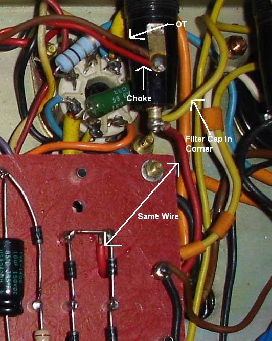

I'm still staring at your pics right now. If there's no tubes in and the voltage ends at that 10K the short is there somewhere, you shouldn't even draw enough current to get those resistors hot without tubes for a load.
I can't see the connections to the filter cap mounted above the board, you might see if you can lift the board enough to double check your work and connections there. The two red wires at each end of the next 10K resistor go there, with a black wire attached to the third cap terminal going to ground, kinda like this:
Red, Red
Black
It's gotta be there or that tube socket wiring somehow I'm thinking, but I can't find it in the pics.

Here's the pic of the current preamp wiring:
I notated the wire that needs moving if you haven't already done that yet.

On the original Park PCB pic, over to the top right there is a bundle of a yellow, thick red and thin red wires. Where are they currently, and are they well-insulated from shorting out? (I think that terminal is just a convenient place to join them together but I'd have to check my '78 pcb to be sure.
Post by Flames1950 » Thu Jan 27, 2005 8:26 pm
My '78 PCB doesn't even have the terminal there, from the pic I'm looking at it looks to be just a junction point that doesn't lead elsewhere on the PCB. What are these wires going to and where are they now?

It's really probably a case of a different wiring method that, electrically, comes out the same. I'd just be sure that bundle didn't get folded under the board and forgotten or something, causing a short at the middle of the turret board. Our problem has really been proven to be past that point in the B+ circuit but it's worth double-checking.
