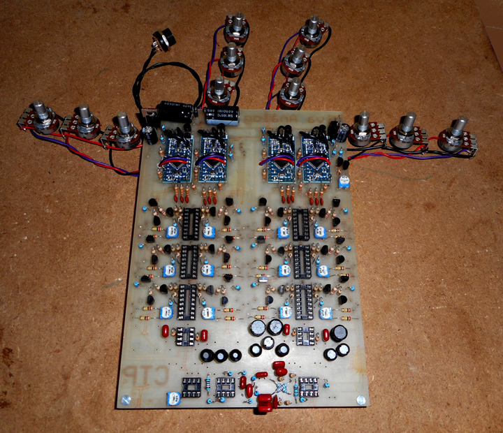

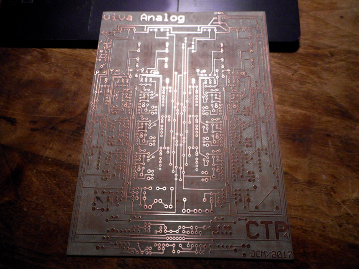

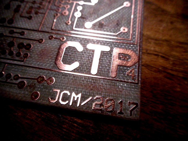

took the plunge, ... I'm about half way across now
biggest and most expensive PCB I've had made so far
http://www.lynx.net/~jc/CTP4pcb.jpg
http://www.lynx.net/~jc/CTP4corner.jpg
following the Baldwin CTP structure very closely
with a few modernizations:
as it stands,
* 4 independently-variable channels ...
incl. OFFSET, DEPTH and SPEED control on each 3-phase oscillator board
so, four sets of oscillator controls
* each channel also has a tank-cut switch, so the Band-Pass function can be inserted, or not ...
recall, the CTP was designed for synchronous "tone-wheel derived" signals
and so we (guitarists) may want to see what happens when we run each channel full-band instead
* each channel will also have its own GAIN control and "kill" switch
* the whole works has a Master Volume control
same tank frequencies as the Baldwin schematic
less lossy summing at the output (should be interesting ...)

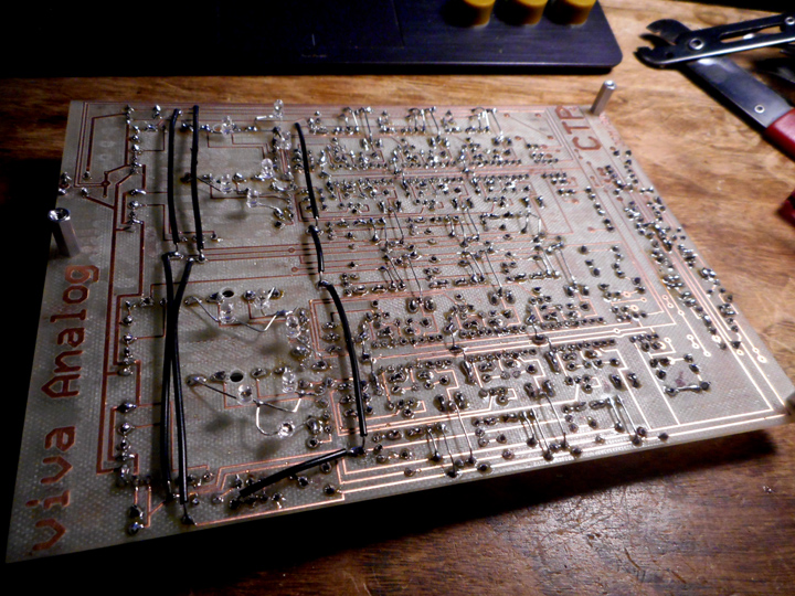

picture shows results after two solid days of soldering
http://www.lynx.net/~jc/CTP4partway1.jpg
so far, I've got temporary LED's on the under side, to show PWM action
later, these LED's will be moved to the front panel
* each channel will have it's own trio of rotating "LFO" LED's to show status
http://www.lynx.net/~jc/CTP4traces.jpg
that side of it now works ... on all four Duino's
checked all the voltages, +/-9 volt everywhere required, etc ...
5volts regulators obviously doing their job
checked out one of the converter circuit without OTA's in their sockets
by adjusting the master bias trimpot I was able to get
a 0.06mA to 0.88mA spread in OTA current
by sweeping the OFFSET control end to end for that LFO
that's roughly 5% to 90% volume variation in the OTA at (close to) full depth
I'll take it ...!!
should provide ample separation between modulated signals A, B, and C
next, I need to snake the A, B and C signals from the lattice to the modulators
same order as they are shown in the Baldwin schematic (ie., orig. patent)
hook up, the kill switches, GAIN pots and MV pot
couple of wires ...
and I should be able to hear it in action
hopefully I can get around to doing that this weekend
although, I have a couple of preamps I have to finish first
should have confirmation soon enough ...
can't wait :wink:
