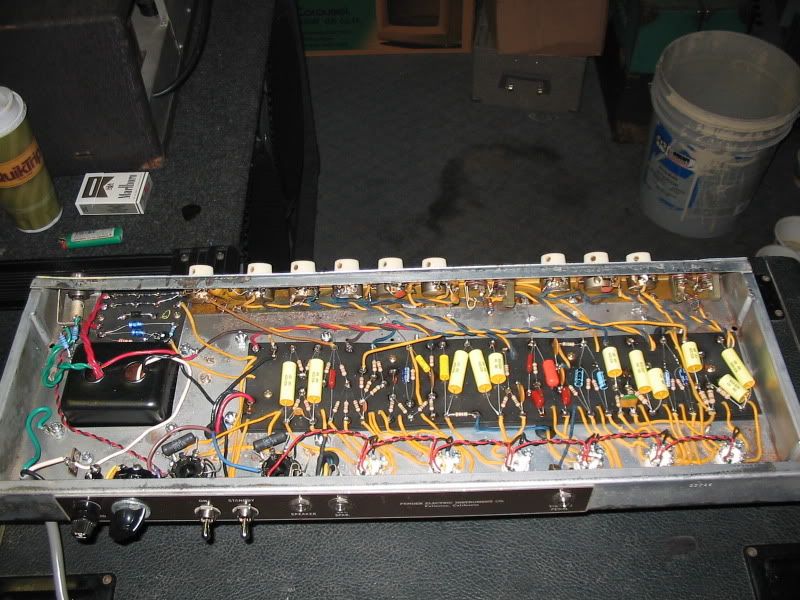

I am starting to get scratchy sound on Normal channel volume, either the .1uf or the .047uf are leaking,Can any of the caps cause this? if I do not change the caps,will this do harm to the amp?and can I use one of the .1uf Mustard caps that Neil gave me, as a temporary...or should I just get a few Mallory or a Sozo blues....

First off---- you have cleaned the pot itself, right ?
The small amount of DC, if it is a leaking cap, won't hurt anything but it is annoying----- I'd save the Mustards for a Marshall type amp and install M150's to see if they solve the problem:

Have you measured any DC at the pots ? The Blue Molded caps used in some Brownface and most Blackface Fenders rarely leak DC (but any component can fail)---- If your amp has the yellow Astrons the DC leakage is more likely.
I rebuilt a Brownface 6G7A Bandmaster that had been in a flood and used mostly Mojo Dijon coupling caps on the board---- nobody who played the amp afterwards could pick out this rebuilt amp in A/B tests with other orig component 6G7A Bandmasters I have:

i'm working on a '67 Bassman that had a similar issue. The Bass channel volume pot was very scratchy. It turned out to be a bad 250pf cap. It was actually a silver mica replacement. For all I know, it could've been the wrong size... my eyesight is starting to go, couldn't read it.

It was the plate resistors on the Normal channel...This poor amp had everything pulled out of it and put back in 2 or 3 times...The guys at Kendricks amps ripped me off for $1,500.00 and it took over 21/2 yrs..I got it back from them ..I found the problem..All that was wrong the plate wires to the power tubes were switched and it had a corroded ground wire under a glob of solder...The Great amptech Skip Simmons fixed it for $50.00
