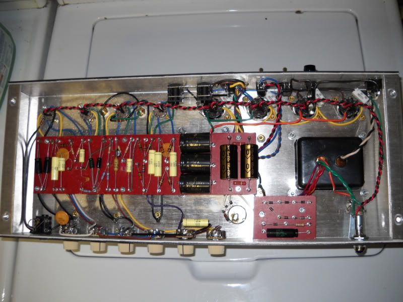

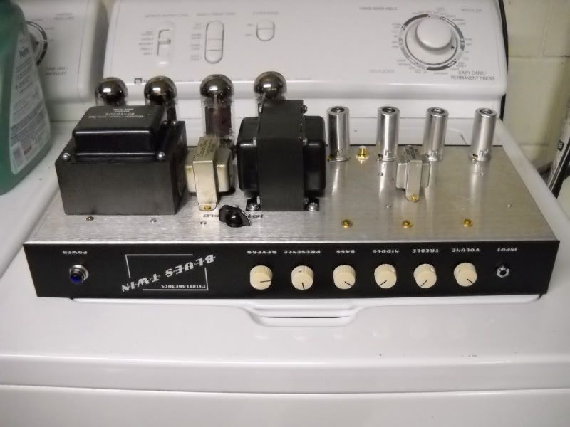

Update: the marsh twin kit lives. it sounds like its supposed to but I havent burned it in yet
plate voltage is 452v, screens the same - shouldn't the screens be lower?
heathers are high: 6.8-6.9v
tremolo seems to be too fast. may have to change a .01 cap to .02 or something

amp is starting to sound like a beast. managed to get a singing lead tone from a strat without pedals (but with a 28k mid pot dimed). however, heather voltage is too high (7v). seem that I need .o1ohm resistor

I've experimented with filtering. much prefer 100uf on the mains over 50uf.
tried 20, 30, 40 and 50uf on the screens. ended up with 40. this is not only because of tightness but because these particular caps had a nicer highend. (f&t 30uf was worst; atom 80s in series best; tad 20uf good)
using the 240v secondary I get 6.7v on the heaters but only 432v on the plates :-/ . wall voltage is 228-237v
