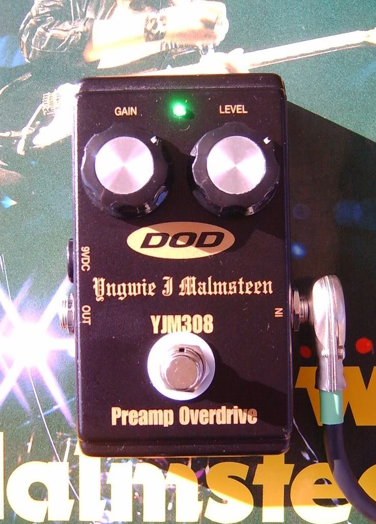

Thought some of you might like to see this, so here's a YJM308 I recently finished for someone on the Yngwie forum. It has the 741 chip, various upgrades, 3PDT footswitch for true bypass and indicator LED and a Boss-style 2.1mm barrel DC input jack.
He'd said he wanted a green LED and being that most normal green LEDs are rather dim, I put in an ultra-bright green LED. No problem seeing this onstage during an outdoor daytime gig.
I also placed the LED in a more conventional position as you can see. I'm not sure why a lot of modders are drilling right through the logo to place the LED. Doesn't look good, but maybe that's just me.

Looks awesome.. I'm going to switch out the DC input jack while I am at it when I get your board. How inconvenient of DOD... Are you going to be doing somesound clips soon? Would be good to hear just the pedal clean and then driving the front end.

I like where you put the LED rather then on the logo. Can't wait to get mine!
