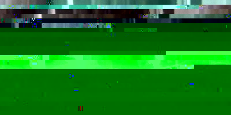

So here's some more pics...
Brimar showing the dual halo getters and welds
Brimar (left) compared to Mullard (right). Can see differences in construction.

Post by demonufo » Fri Nov 15, 2013 7:32 pm
Those Brimars are Tesla's. Probably Trinec's, rather than earlier Rosnov's.
I bet they have a slight heater filament rattle to them when you shake them in comparison to the Mullards...

:thumbsup:
I gave them a very weak shake and yes, the Brimar does rattle noticably more than the Mullard.

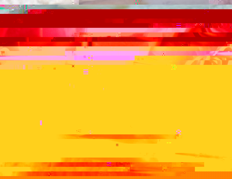

Does anyone know anything about those Mazda valves?

Post by demonufo » Thu Nov 21, 2013 1:19 pm
Can't see much from that pic (too much glare)
It almost looks like a box plate.
BUT, I'm thinking it could be a late Tesla frame grid E83CC (a very authentic copy of the Siemens E803CC which is probably the most sought after ECC83 type there is)
Compare it to this pic and let me know.
http://www.google.co.uk/imgres?imgurl=h ... CEcQ9QEwBA" onclick="window.open(this.href);return false;
If so, you just picked up a TRULY AWESOME tube. Probably one of the strongest phase inverters you'll ever find.
