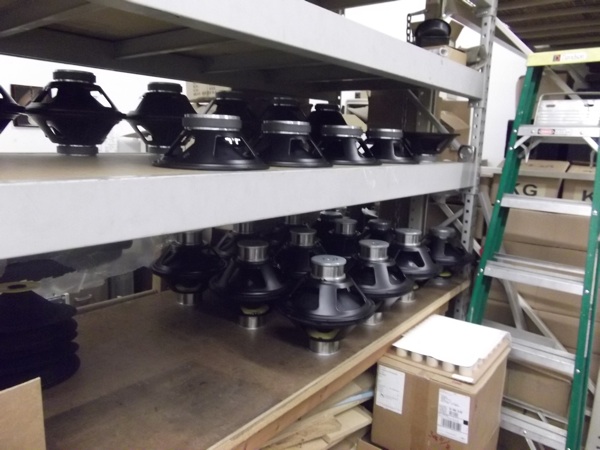

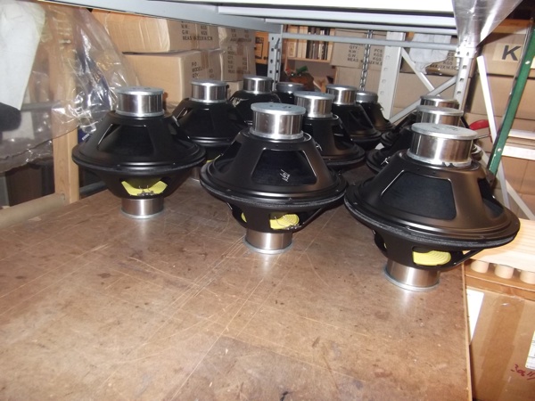

Scumbacks finished and getting ready to ship! The California production crew has been working through the weekend. I expect all of my back orders to ship out within 8-10 days.

Your new speakers look great! Hey...please let us know when you get your BB 75 clips together. I'm really looking forward to comparing them to your M75s.

The BlackBack M75's (BM75 series) got rave reviews at the LA AMP Show. Pete Thorn already tried them, digged them and I'm going to hire him to do all new Scumback clips from the California production crew. He's on tour with Don Henley right now, so that will be happening in November.guitar007 wrote:Your new speakers look great! Hey...please let us know when you get your BB 75 clips together. I'm really looking forward to comparing them to your M75s.
And thanks for the kind words on the speaker's looks. They have the tone to match, too.

Lookin good Jim!
