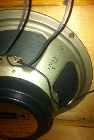

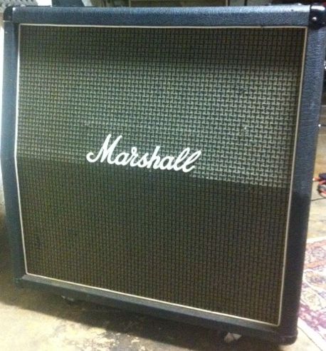

They would fit for the style of the chassis (hammered paint finish, frame codes and black backs).
Mid late 70s I guess?

Codes on speakers are JL5, September '78 5th day?

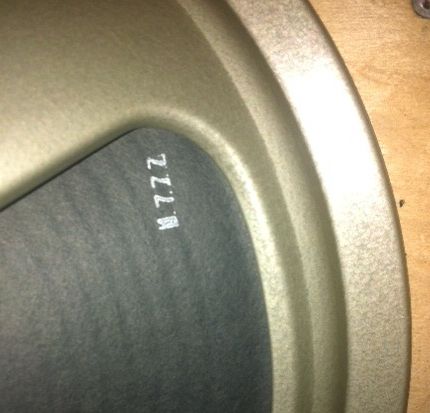

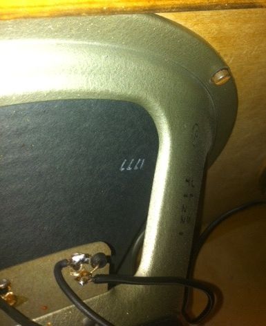

I did buy the cab. They all have the 1777, but three are in one font style, and one is different. I think you can see it in the pics.
The odd one is third pic down.

1777 cones are right for blackbacks for sure.
does it sound good? - that should be all that matters (unless you paid an insane amount of money for vintage speakers of course).

It sounds okay, I am currently playing through GT12-75's. It sounds very middy to me, with less bass comparably. I am going to see if it is wired correctly today.
I paid $650 for it based on the questionable "1777"'s on the cones.

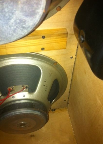

The speakers have clearly been out of the cab and rewired at some stage. Normally the speakers are arranged with the solder tabs vertically arranged in the centre of the cab so the harness is Y-shaped. Black/red wire is usual (same as heaters I think) although 71-73 ish there were some wired with blue/brown wire - maybe someone else could be more definitive. The three code stamps in your pics all look correct.
I agree with HTH - do they sound good to you?

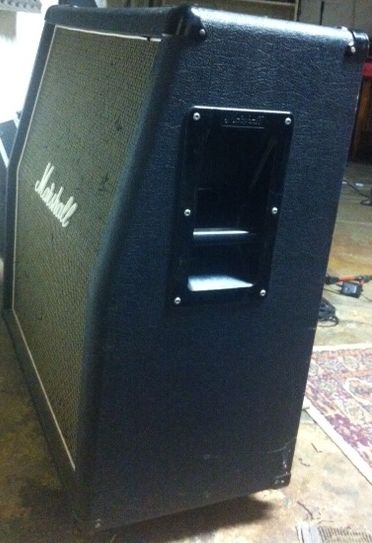

No idea on price but those late 70s black cloth cabs can be got for 350-400GBP although one nutter has had this going for years - increasing the price http://www.ebay.co.uk/itm/Marshall-Vint ... 2327ed3343

I'd say that is a very good price for the cab and speakers. I do see a rewire in there and at least one of the speakers have been turned.
