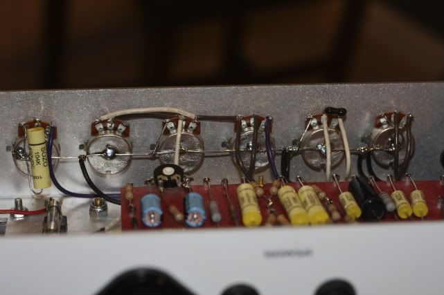

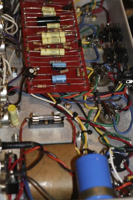

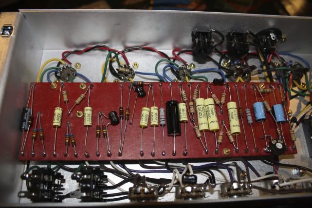

Ok, I've been enjoying my new amp for about a day now and every once in awhile I get this loud hiss that comes and goes. It doesn't seem to affect the tone, but you just have this hiss sound over it. If I turn the stand by off it goes away again for awhile. It very intermittent.
Any Ideas???
Posts: 7231
Re: My First Build... what fun and what tone!!!
Post by neikeel » Wed Oct 27, 2010 11:57 am
Intermittent hiss maybe a dry joint on the B+ (power supply rail) - those grey MO 8k2 and 10k droppers although the hiss from a vintage amp with this problem is usually from the old carbon comps that were used so not necessarily the issue in yours. Nevertheless an intermittent problem like this on a newly built amp that otherwise works well will be a cold joint where you are not always getting signal passing properly, and occasionally getting a higher resistance to (or in some circumstances complete loss of) the electronic signal.
Usual method is to go over every solder joint and inspect it carefully, if any doubt reflow the joint with the soldering iron on the correct temperature and make sure the solder flows into the joint evenly.
A hiss or whooshing noise maybe a poor preamp tube.

Thanks Neil,
I have checks the solder joints and a couple were suspect, re-flowed them and am now testing. We'll know soon.
Thanks,
Kris

Post by TheOuvs » Wed Nov 03, 2010 7:30 am
All is well... hum is gone and the amp sounds great. Been playing for days and no signs of the hum returning.

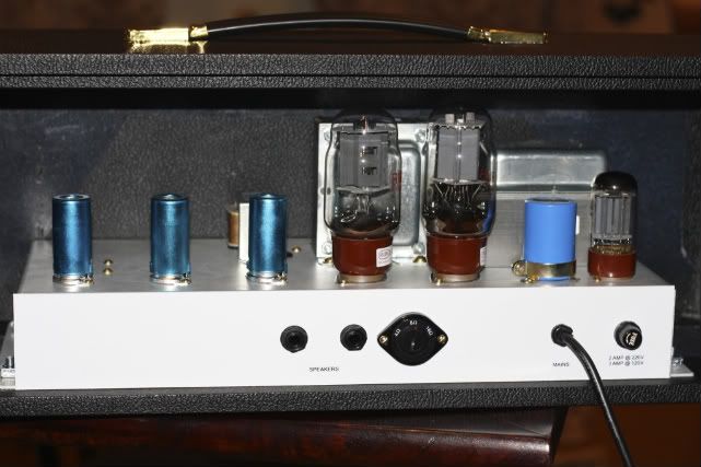

Post by j.christopher » Thu Nov 04, 2010 2:08 pm
where did you get those cool blue tube cans?

Post by spaceace76 » Thu Nov 04, 2010 4:15 pm
j.christopher wrote:where did you get those cool blue tube cans?
metro sold preamp tube covers in various colors before they began reformatting the store

Post by Drawbarbarian » Fri Nov 05, 2010 4:06 am
Check this link out, I recently found the site. I currently have parts on order from them. I too am a sucker for colored tube shields........

Post by j.christopher » Sun Nov 07, 2010 2:58 pm
http://www.newoldsounds.com/index.php?m ... ld&x=0&y=0" onclick="window.open(this.href);return false;
great!
I think maybe the res ones!
thanks
