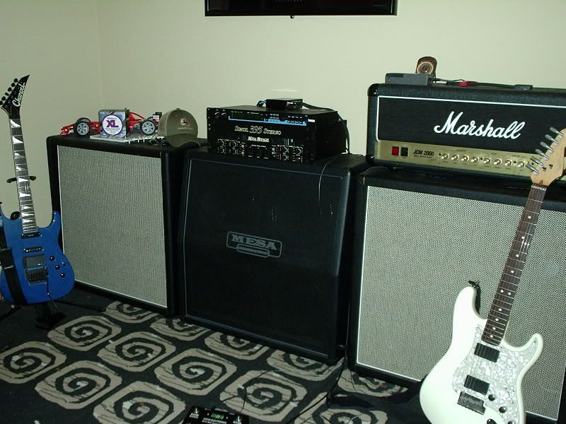

I run a w/d/w setup with three 4x12's with a Mesa boogie 395 simul class power amp.
Lead 80's on the sides and v30's for the dry.Image

heres what it looks like. Image
