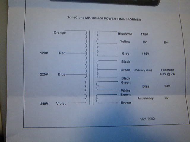

Could someone tell me where these wires go?? Thanks MArk Some are obvious but I want to make sure I get it right

this should help. what amp is this going in? does it have a voltage switch? i have no idea what the 9v taps are for on yours.

Thanks I seen that on your layouts. Its going in a new 1959 reissue. Its a regular one (not H.W) but is also getting a ptp board.It has a voltage selector

so assuming you selector has a 120,220 and 240 selections u would wire it up accordingly. still wonder what that 9v tap is for.
if u are taking one out of a reissue you should make note of where the PT wires go and be clear on where they go before u remove it so u can make your own diagram.
where in my diagram it says standby switch on yours could be right on the diodes.
so before u remove it you should learn your current pt's connections.

Sounds good,On this amp it currently has a resistor on all 4 center filter caps. On the layout only 2 filter caps have resistors. So should I follow the diagram or just leave all 4 resistors alone??
