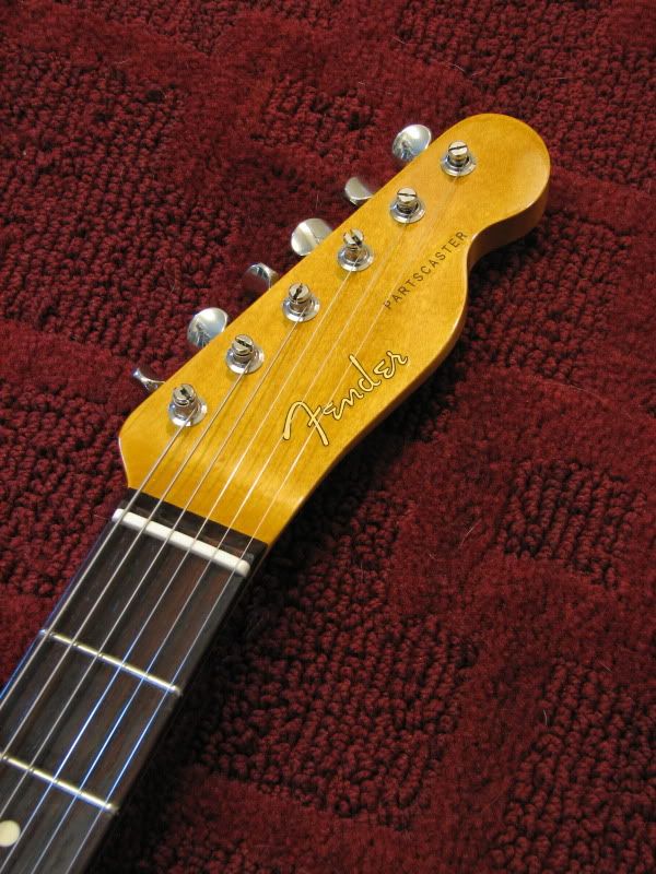

If you are a DIY type guy then you could order a huge boat neck and then shape it to your desire.
Of course this would require you to finish it but that is really easy to do.
Especially if it is a rosewood fretboard.
I like to use Tru Oil for my necks. A lot of people call it gun oil like G & L guitars do.
It's made for finishing gunstocks and is a very durable finish.
It is a type of finish that gets hard so not really an oil per say but a type of varnish.
It is rubbed into the wood and after about 6 to 8 coats it's done.
It has the best feel of any neck finish I have ever tried.
If your hand gets sticky when playing a lacquered neck then this might be the ticket for you.
It has a very slick and fast feel to it.
This is the last neck I did for my P90 telecaster.
It is a Allparts TRO-C neck, best bang for the buck IMHO.
It is tinted with Vintage Amber and a touch of brown waterbased stain then Tru Oiled.
The picture makes it like far more yellow than it looks in person.
It has the classic amber look of a vintage neck.
I do spray nitro lacquer clear gloss on the headstock and heel so it will age there like lacquer does but the back is completely Tru Oil.
