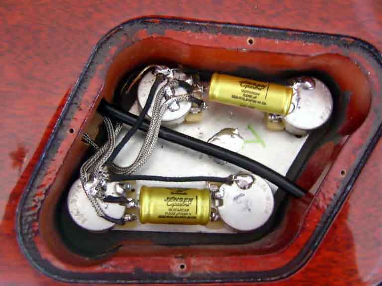

I put RS Guitarworks Vintage pot and harness kit in my Lester and the difference is night/day over Gibson stuff. RS matches all their pots which to me makes a big difference in not only the tone but how the pot reacts to roll-on and roll-offs. Also, with the Vintage kit you get the Jensen tone, caps i.e. .022 bridge & .015 for neck respectfully, which to me are as good as the high dollar Bumblebee's. The wire harness that comes with the RS kit is all shielded and is the best. The guys at Les Paul Forum sware by the RS kits. This is what my Lester's contols look like after I installed and wired the RS Vintage kit to 59 specs myself. In 1977 Gibson made the change from the short shaft to long shaft pots and I beleive they changed for a short while to 300k pots but quickly went back to the 500k. Typically it's 500k for gibson having the Humbuckers and 250k for Fender with single coils.
