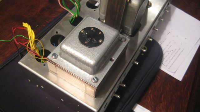

That is such excellent work. Very inspiring and a 1000 times better than anything I have done.
But...
IMO: I would use shorter mounting bolts for the Imp Switch and the IEC... :hide:

Ah he used the 6BA board stand offs I sent!!
Do you want some shorter 4BA (correct size :wink: )?

Actually I used some US thread stuff on this one, but thanks for the offer Neil! I've taken to using board mounting bolts for the impedance switch and IEC inlet, just got tired of struggling with the very short bolts I typically used before. I've been meaning to cut them down, just haven't got around to it.
Thanks for the kind words everyone! I recently finished a '66 style JTM45 as well. Will do photos eventually. Also need to finish up the block logo clone which is now power transformerless...need to get the proper one. Nudge, nudge Neil...;)

I have pictures as it arrived, but need to cut the selector hole and silver hammerite the cover :oops:

A photo as it came will do!

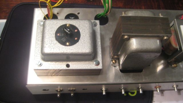

shakti wrote:A photo as it came will do!
http://i76.photobucket.com/albums/j2/ne ... G_2448.jpg
http://i76.photobucket.com/albums/j2/ne ... G_2447.jpg
Here it is in situ with it painted and the selector plumbed in 8)
