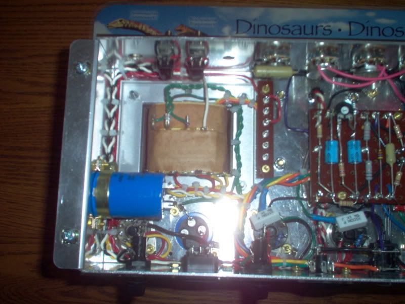

Post by myfoot » Thu Mar 04, 2010 10:22 am

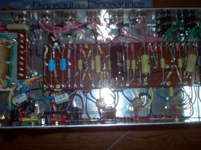

Took me about a year to source parts and decide what I wanted to do with this. Started out with a regular JTM50 board from BrianH here but decided I already had done one of those already so I got some turrets and added a couple and ended up with a 50 watt lead with a tube rectifier.

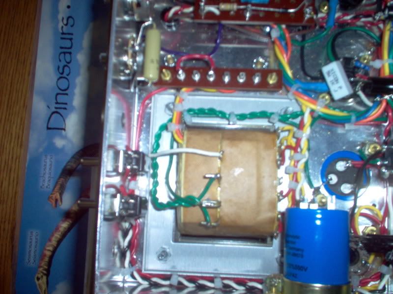

Ceriatone chassis , marstran transformers ( almost put the dual voltage switch in (bought one ) but decided there just wasn't enough room to squeeze it in. BrianH's board and tag strip I had him make for me to use for the 5 voltage taps on the Marstran transformer
Of course using that I had to move the fuse to the back panel so I have one of his fancy fuse holders for my next build :D
Kind of crowded on that side with the rectifieer wiring
Had enough wire on the output primary to run around the socket and away from the secondaries . I was going to use my set of Sozo vintage on this one but I would have had to order some more 022s and had enough 018s and some .68s so I figured what the hell :)
One bug I had with using the pink wire ; I had the wiper of the treble and mid pots reversed :oops: didn't take to long to figure out something wasn't right .
