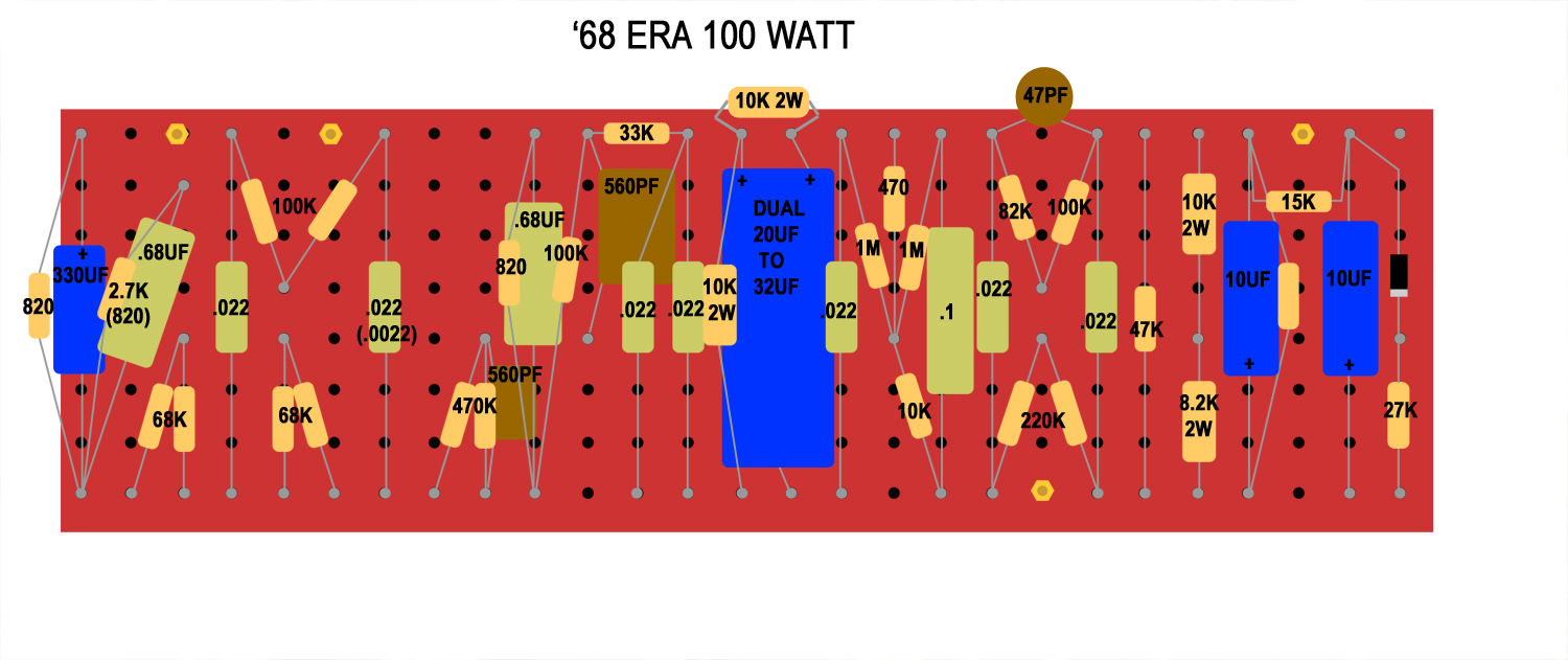

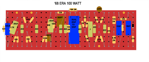

Here's the standard '68 100 watt layout. Of course you will see variations and value differences.
The .68uf cap in parallel with the 820 in V2 shows up intermitantly.
The 330uf cap in V1 is often a 250uf.

Post by VelvetGeorge » Fri Aug 12, 2005 3:31 pm

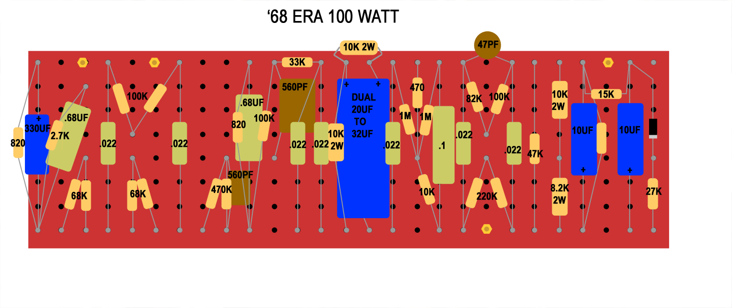

Here's a smaller preview.

This is the slightly later '68 version with the 2k7/0.68 split cathode arrangement. The earlier version has the 820/0.68 for the split on V1. Actually, from what I've seen "most" amps with the 2k7/0.68 cathode setup don't have the pre-amp filter cap on the tag board rather Marshall already made the switch to the six top mounted filter cap style by then.

Most of the '68 split cathode boards I've seen have 820 ohm/.68uf on V1b. Also, the V1 to V2 coupling cap from the bright channel should be .0022uf not .022uf.

Here's an updated diagram with the alternate 820 in V1 and the .0022 listed.
