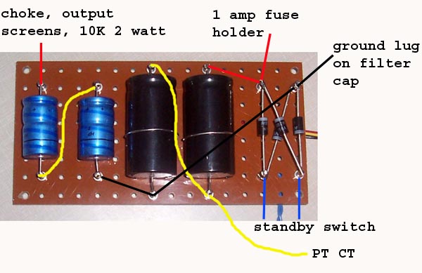

Post by VelvetGeorge » Mon Jan 16, 2006 6:29 pm
Here's a pic of the bottom of a 12 series board I just wired. I thought this would be useful.
cap board bottom wiring.jpg (62.41 KiB) Viewed 59431 times
Post by rockstah » Mon Jan 16, 2006 6:30 pm
george can you show us the top of that board also?

Post by Guitar Adjuster » Mon Jan 16, 2006 6:33 pm
Thanks George, this is a life saver. I appreciate your help with my 12xxx build.
Allen
Post by VelvetGeorge » Mon Jan 16, 2006 6:41 pm
Sure.
Allen, your email is what prompted me to take these pics. Glad they help.
VG
cap board.jpg (64.77 KiB) Viewed 59415 times
Post by rockstah » Mon Jan 16, 2006 6:42 pm
excellent!
i notice the diodes are in a different direction as Dan's layout - but it still works the same. is the way you have it more true?
Mark

Post by Guitar Adjuster » Tue Jan 17, 2006 1:02 pm
George,
Just so I get this correct on the wiring....the Red wire on the board goes to the HT Fuse, Yellow goes to the PT Common, Black goes to ground somewere under the board?
Thanks,
Allen Jones
Post by VelvetGeorge » Tue Jan 17, 2006 1:15 pm
Yellow is the PT secondary center tap.
Run your ground over to the filter cap can mounting bolt.
Guitar Adjuster
Posts: 1560
Joined: Mon Oct 31, 2005 8:34 pm
Location: San Antonio
Post by Guitar Adjuster » Tue Jan 17, 2006 1:28 pm
The yellow secondary tap on the Hayboer PT is also a Yellow wire between the 2-blue (heater) and white (bias) wires? According to the diagram it has 0 va/c? Correct? I just don't want to blow this thing up first time I turn it on :)
Post by VelvetGeorge » Tue Jan 17, 2006 1:30 pm
That's correct.
Post by VelvetGeorge » Tue Jan 17, 2006 1:38 pm
A new diagram.
VG
cap board wiring 2.jpg (58.98 KiB) Viewed 59345 times
Post by rockstah » Tue Jan 17, 2006 1:42 pm
thanks george!

Post by bluze81 » Tue Dec 26, 2006 12:04 am
VelvetGeorge wrote:Sure.
VG
George what brands and values are these caps in the picts,bluze
Post by rockstah » Tue Dec 26, 2006 1:17 am
two ( black) F&T 100u caps
and two ( blue) BC 33u
