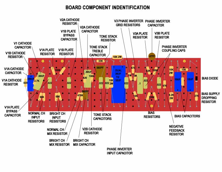

Here are the technical names for some components on the board.
I'll try to add some "also known as" names. i.e. "bright cap" and such.
