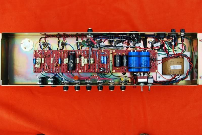

I need to experiment with the Preamp Tubes cause this thing has WAY more gain than my previous builds.
Metro Dual 1203-80 PT
Marstran C1998 OT
Marstran C1999 Choke
Split Cathode
330uF on V2
4700pF Bright Cap
EH 6CA7 Power Tubes
EH 12AX7 Preamp Tubes
.047 PI Caps

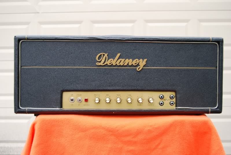

Hello Walter,
the Cassis look pretty good - the Headshell not ! :shock:
Please wear new Tolex on the Headshell....or take e better Headshell.
It look like a new clean Porsche in a dirty old Garage.

The Headcase was leftover scrap from a round I made a few years back. I was really under the gun timing-wise to finish, so it got sloppy at the end....it's functional, but not pretty.
