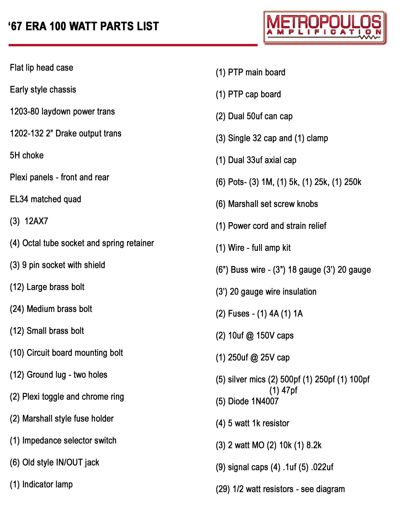

Post by VelvetGeorge » Tue Aug 23, 2005 10:01 pm
This should be pretty complete. Let me know if you guys see anything I missed.
Update: I have added the early '68 12 series 100 watt parts list.
68 100 watt parts list copy.jpg (138.42 KiB) Viewed 39486 times
(218.58 KiB) Downloaded 1604 times
Last edited by VelvetGeorge on Mon Dec 12, 2005 10:38 pm, edited 3 times in total.
Post by VelvetGeorge » Tue Aug 23, 2005 10:24 pm
I'm pretty sure I included everything. There are items that you can choose what you want to use, like tube sockets, tubes, transformers ect.
Everything on the list is in the store except the flat lip head case and the boards. I'll work on getting those listed tomorrow. I'm just out of steam tonight.

Just one thing... I couldn't find the 0.1uf PI coupling caps... Part from that, excellent work, George
Post by Flames1950 » Thu Aug 25, 2005 12:39 am
Ralle 500 wrote:Just one thing... I couldn't find the 0.1uf PI coupling caps... Part from that, excellent work, George
No, it says (4) .1uF's and (5) .022uF's........all on the same line.

Shouldn't there also be (2) 820ohm 2 watt metal Oxide resistors listed on the parts list as well?
Post by VelvetGeorge » Thu Aug 25, 2005 12:01 pm
Yes. Either 2w MO or 1/2 NOS which are long enough to fit across the board.
See... I told you I need new glasses...

Hey, George (Dan, Andy?) can you post a 45/100 parts list? I planned on doing the '67 from the bare bones kit but since I have <ahem> come across 45/100 panels I think I'll need to do that instead!

excuse me if i'm spacing out here i'm new to 100's! is there really:
(quantity) (3) single 32 cap & (1) clamp ???
(i'm trying to get the parts together for my 12k! thanks guys :D
Post by Flames1950 » Thu Jun 15, 2006 6:01 pm
45auto wrote:excuse me if i'm spacing out here i'm new to 100's! is there really:
Yes......two of the 32uF caps are mounted on a turret board under the chassis along with the two 100uF caps. The other 32uF mounts above the chassis with a clamp (make sure you get the single 32 can type for this one!!)

Andy, if use a JTM45 component board with the 7 32u cap board I've got the 45/100 circuit correct? (Of course with the correct tranny's and choke.)
Which choke did you wind up leaving in yours?
Post by Flames1950 » Thu Jun 15, 2006 10:56 pm
I think so....I can't think of much that's different between the two main boards, although sometimes the JTM45/100 had one extra turret in the corner by the bias circuit for the junction of the choke and filter cap wires. My Super PA has it, my first clone doesn't........
