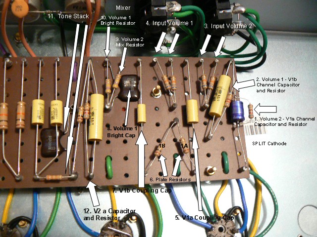

In an effort to better understand what I am looking at I made some notations on 1 of my pictures. Please let me know what I have right and what is wrong. Thanks again!
Picture edited and revised 5/11/07.
- 1959HWPartsID_1.jpg (127.73 KiB) Viewed 20448 times
