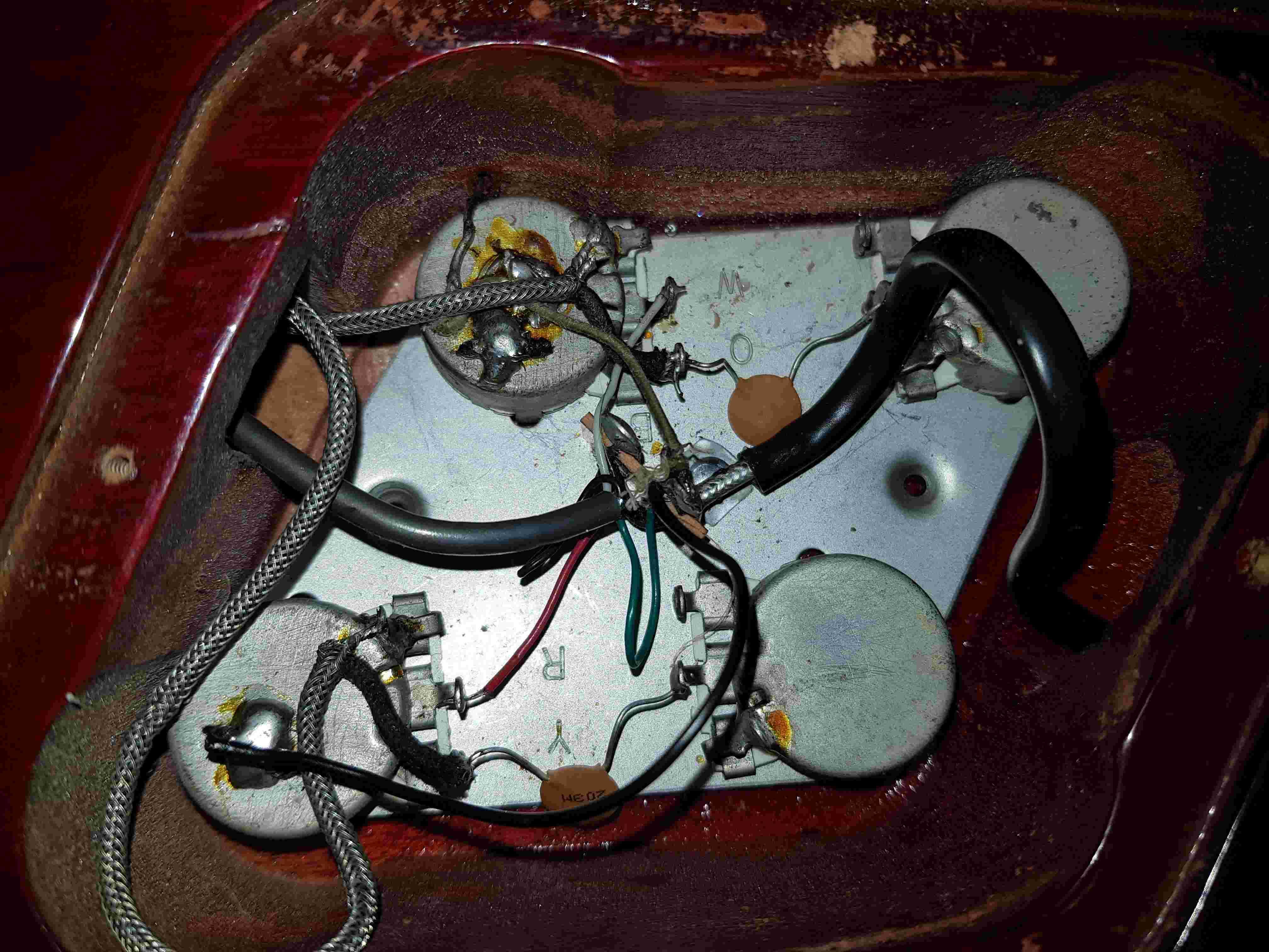

I have attached a picture of the electronics in this gibson, it also has the metal plate.CoffeeTones wrote: ↑Wed Jan 11, 2023 9:40 amWhy not just move the cap connection at each volume center lug in order to have 50"s wiring? Or do you want 500k pots as well? No need to change the tone pot connections because the pot is only acting as a variable resistor either way, so there is no need to alter the tone pot connections.
https://i.pinimg.com/736x/92/ab/56/92ab ... b7dcb5.jpg
I remember I did as you say, in other gibsons I've had, I don't remember the result. Maybe it's better to remove everything and replace it, I'll think about it.

No need to change any components in the guitar to have 50's wiring except the tone cap connections at the volume pot unless it is just something you want to do. The guitar will sound more vintage / PAF like and more user friendly with the control adjustments. Easy to reverse if you don't like the results.

I agree with what Coffee says, and if I was you, I'd get yourself some 500k pots and you'll lose the 'low-mids' your describing. While you're at it, grab some Sprague .022uF 192p caps (these are cheap on eBay), any voltage rating will work fine. These caps are very transparent, and IMHO, they are the best sounding caps I've ever used. Also, they are what Slash has in his Derrig These things will 'liven' up your sound, probably a lot since you're using 300k pots. It will sound like you took a blanket off your speakers.

I just saw your pic of your electronics compartment. Get rid of the metal grounding plate, you don't need it and it's unnecessary weight. Not only that, but I think they are tone killers. For 50's wiring, flip-flop your caps connections, connect to the center lug on the volume pot, and to the far right lug (from picture angle looking down) on the tone pot.

No need to mod the tone pot connections. It functions the same - adjustable resistor.Unique wrote: ↑Wed Jan 11, 2023 2:04 pmI just saw your pic of your electronics compartment. Get rid of the metal grounding plate, you don't need it and it's unnecessary weight. Not only that, but I think they are tone killers. For 50's wiring, flip-flop your caps connections, connect to the center lug on the volume pot, and to the far right lug (from picture angle looking down) on the tone pot.

True. But with a 500k tone pot you get a more defined range to find sounds. It's not necessary, but since pots are cheap, and if you're going to be swapping pots anyway, you might as well do them too.CoffeeTones wrote: ↑Wed Jan 11, 2023 2:43 pmNo need to mod the tone pot connections. It functions the same - adjustable resistor.Unique wrote: ↑Wed Jan 11, 2023 2:04 pmI just saw your pic of your electronics compartment. Get rid of the metal grounding plate, you don't need it and it's unnecessary weight. Not only that, but I think they are tone killers. For 50's wiring, flip-flop your caps connections, connect to the center lug on the volume pot, and to the far right lug (from picture angle looking down) on the tone pot.
