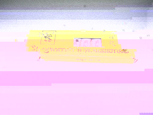

-12 x Welwyn 1k 3w W21
-4 x Welwyn 1k 5w W22
-4 x Ohmite 1k 5w
-4 x Xicon 1k 5w
-4 x NOS RS 470 ohms 5w

some more pieces. getting closer ....
old selectors - RS wirewound resistors 470 ohms 5 watts. perhaps for some kind of 7026 build.
- (357.94 KiB) Downloaded 1163 times
- (367.06 KiB) Downloaded 1163 times
- RS wirewound resistors.jpg (40.67 KiB) Viewed 6627 times
