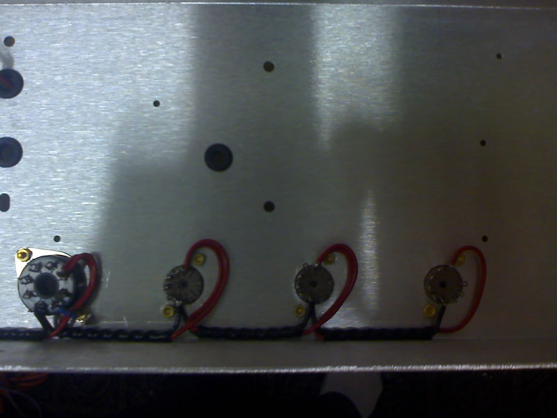

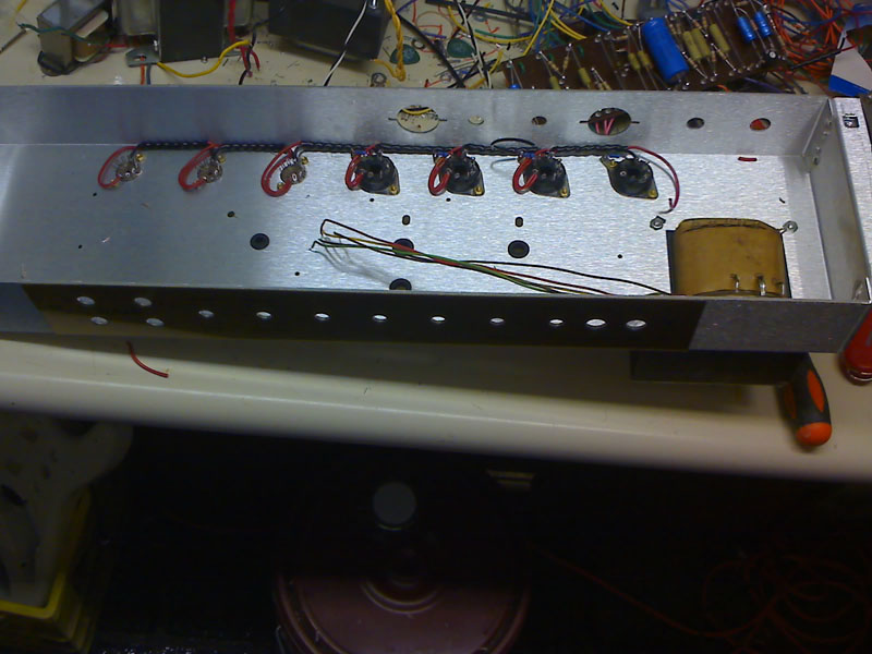

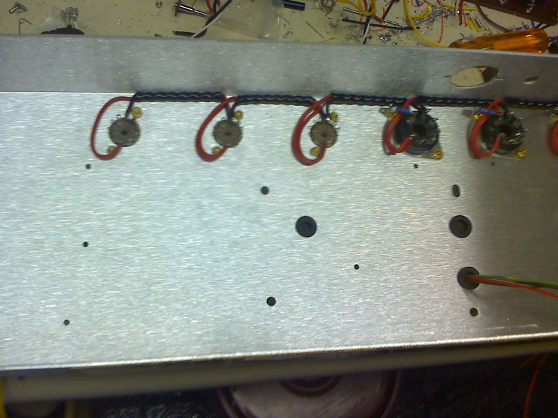

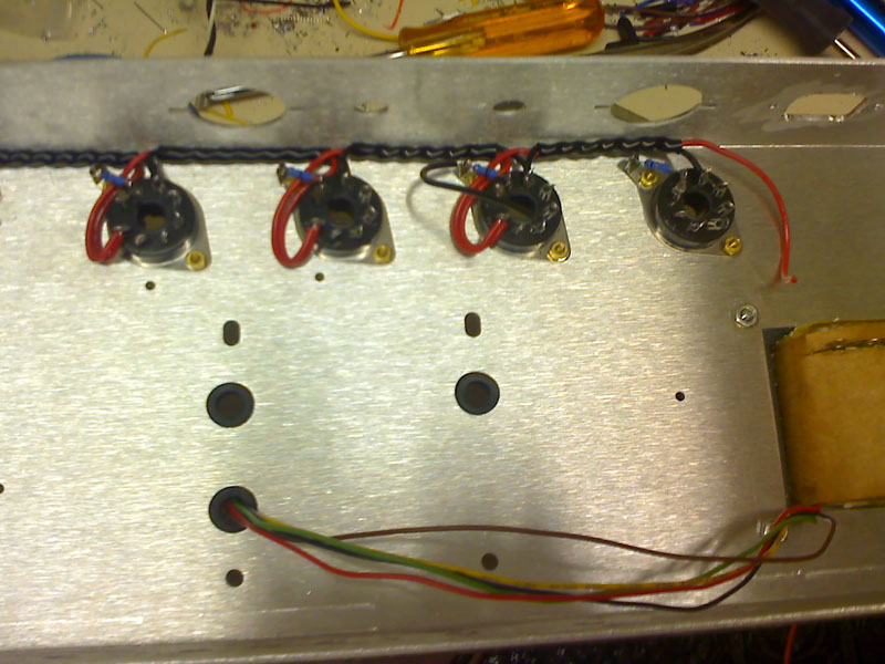

I started doing my heater wiring tonight... I prefer to get everything twisted and fitted before I spark up the soldering iron... below are some pre-soldering pics... I'll heat up the iron later tonight 8) :D 8) :D
