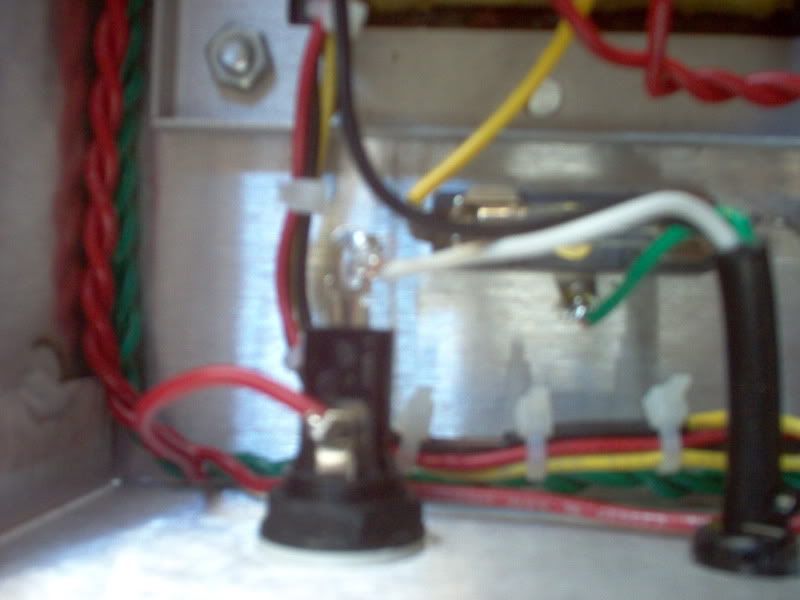

While I"m waiting for an answer to the above question I thought I'd post a few pics. First one shows where I grounded the main line at. I added a lug under the fuse. Read in one of the pdfs that it should be grounded by itself and I didn't want to drill another hole.

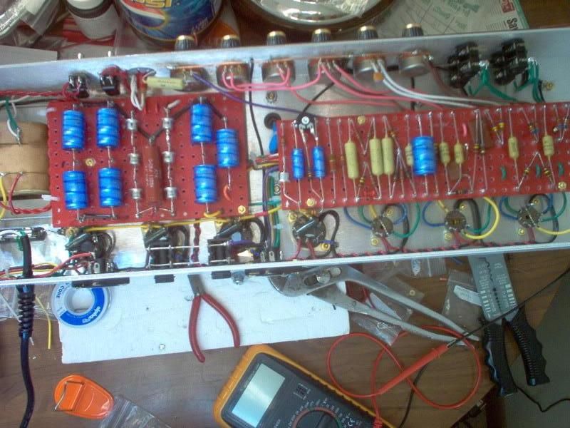

Next is the cap board.
Finally a shot of the whole thing

looks absolutely great. do you have source for the lemcos? :wink:
myfoot
Re: Almost there
Post by myfoot » Mon Feb 02, 2009 2:19 pm
Roe wrote:looks absolutely great. do you have source for the lemcos? :wink:
Sparky :wink:
