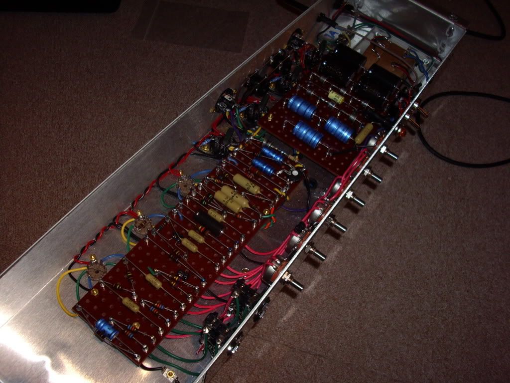

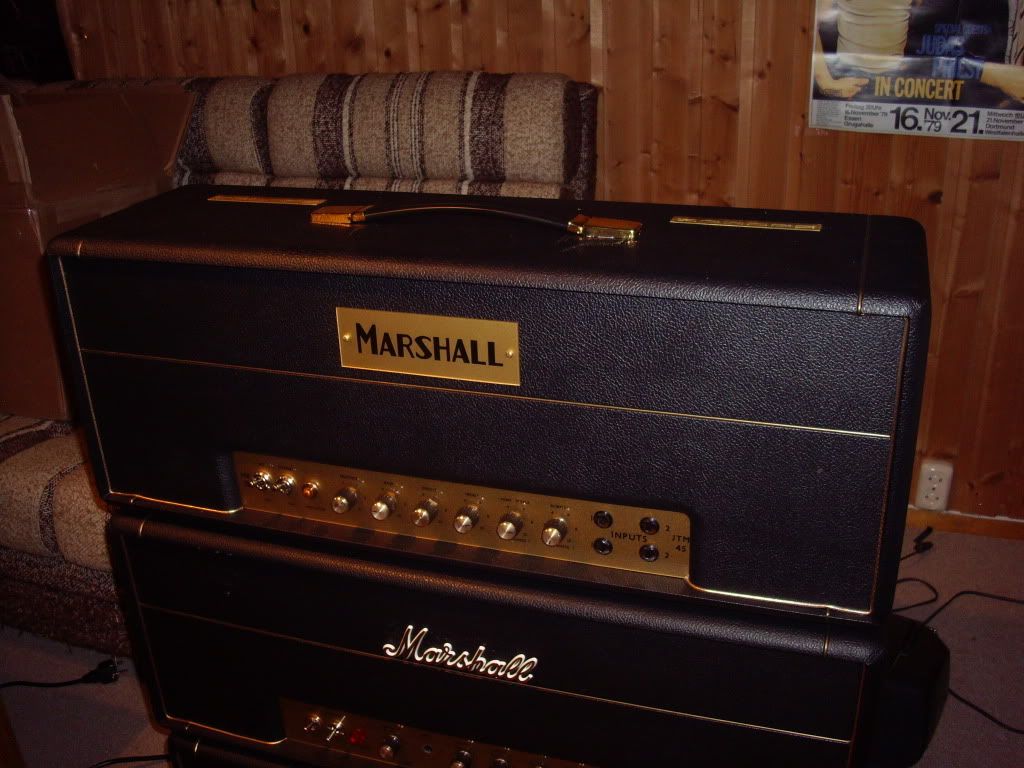

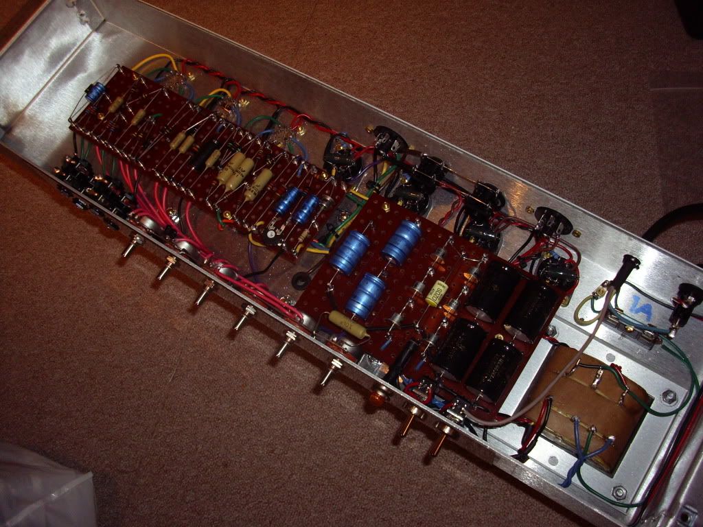

I completed the amp today! No problems, works great. Dead quiet when not playing.
Alittle dark sounding. Dont think i like the AB CCs in all positions...
http://i267.photobucket.com/albums/ii28 ... CI0021.jpg" onclick="window.open(this.href);return false;
http://i267.photobucket.com/albums/ii28 ... CI0019.jpg" onclick="window.open(this.href);return false;
http://i267.photobucket.com/albums/ii28 ... CI0018.jpg" onclick="window.open(this.href);return false;

Nice! Congrats, I think I may use all pink wire for the pots on my next one too.

Seriously - awesome looking build - Brians boards ??
What plate volts did you end up getting on V2 ?
and what pre amp tubes did you end up using ?
Mine was around 360 and i've been a little worried about it for a while - but all seems ok still after a month or so.

Yes, thats Brians boards! Theyre beautiful!
I have JJ in V2 and Sylvanias in V1 and V3 !
Let me check Vp on V2 tomorrow, i dont remember exactly : )

Is the block logo or script logo considered to be correct for a 45/100 or can it go both ways? I can't really pin it down either way for memory.

I'd say mine is almost the same as yours - spec wise. Mustards & CC's, filtering looks identical though I do have the dual 32uF on board with an extra 10k to V1. I might disconnect one leg on this at some stage just to see if there is much difference. I used the erie coz it looked cool ! (sad - but true).
I have all JJ's in the preamp.

Not sure about the block logo or script either. I just copied one that i saw on amparchives which had the script logo. The re issues have a block logo though. Either way - i don't think it matters. Looks good both ways !

Wayne, my Vp on V2 is also 360V! And it also says 360 in the Voltage diagram...
