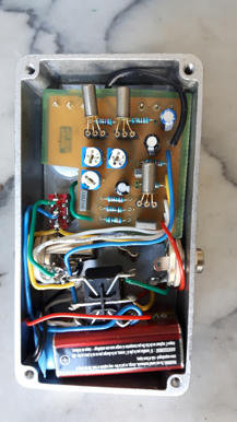

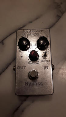

Here is it, (wrong switch i know but work as-is). sound so frigging awesome for woodstock.
Its a kind of tonebender mkII with the first transistor re-arranged as a input buffer. the switch is for that. When the fuzz is in bypass mode you can still use the germanium buffer or not.
And it has ALOT of volume output, great for a clean fuzz.
