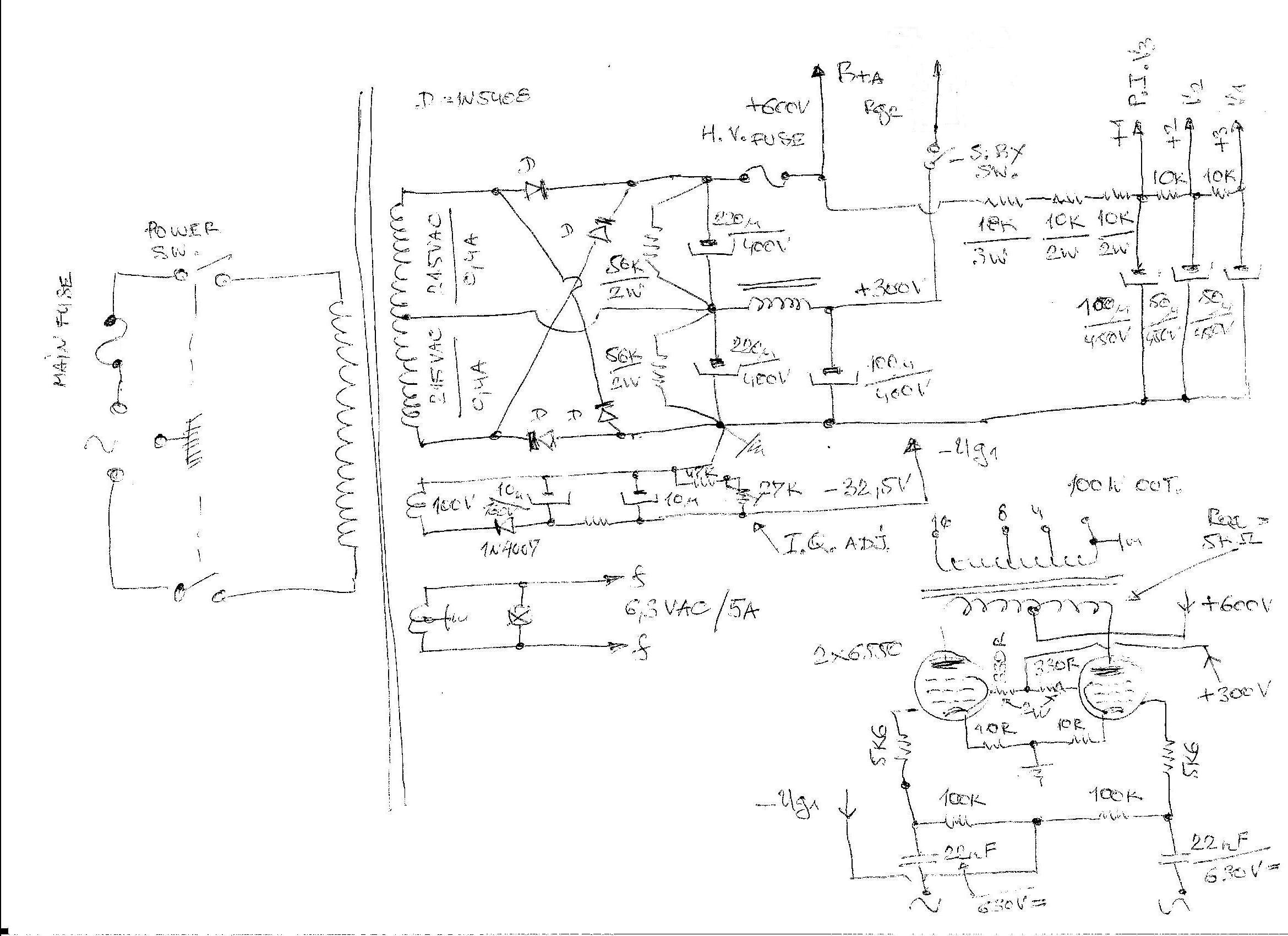

Anyway. Like shakti I recently returned my JTM100 mongrel to Weyer-specs. One of the 6550's burnt up a while ago so just running a pair in there at the moment. They seem plenty worn though.. the third one that still lives but is not used has drifted in its matching that it bias 10+ mA below the others. New ones needed and I just ordered a quad of 34's for my hiwatt..
So what I did today:
- Put in a pair of 6550's. Biased down to 30 mA and then turned it a nudge hotter to regain a little sustain. Ended at 33 and 34 mA.
- Put an 12at7 back in the PI
- Wired NFB to speaker jacks
- Played around with some cap values: dropped the V1b plate resistor to .0022 uF - added V2a cathode capacitor (330 uF) - dropped PI coupling caps to .022 uF - played around with bright cap values: snipped it and left it that way.
So now I am truly left with a mongrel of Marshall 100w designs from 67-69.. But I think it sounds glorious, the capchanges added some more bite - that I didn't use to care for since I felt it removed the clarity that I wanted. With Dave's recommended mods and the 6550's I find there is clarity in spades and thus lots of room to add a bit more bite and grit.
Then I ran in to some probs however. The heaters measure 2.8 Vac per side.. Doublechecked and I'm running the 240v tap and my walloutlet puts out 236v last time I measured. Time for a new PT?
So to my question. If it is indeed time to fit a new PT I would like to get a JTM100 so I can get the plate voltage up (currently 521 Vdc). Since I also need new tubes: Dave, do you reckon a set of new production of 6CA7s would hold up under those conditions? Or should I just get a new set of 6550s?

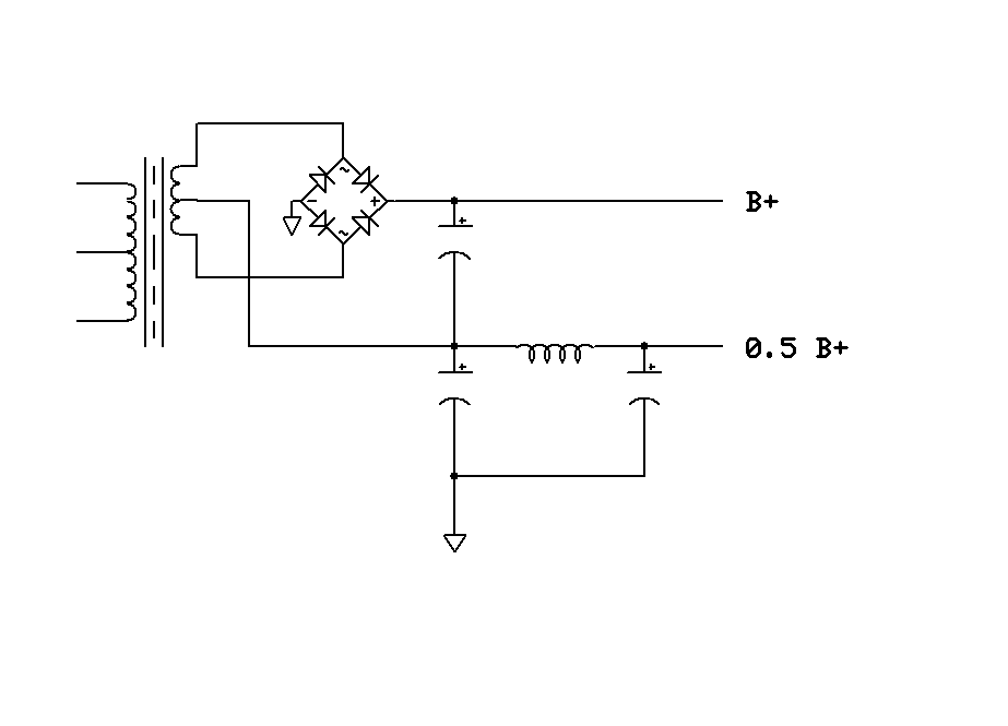

And one for Dave: could you maybe elaborate more on how one would go about to build a separate voltage supply for the screens in the amps we are discussing here?

- with 238VAC from outlet connected to 220VAC PT tap you should get the highest secondaries voltages , including 6,3VAC tube filaments voltage to , but in case that you can not get 6,3VAC than that PT is sub-optimal or to small for your specific output power tubes conversion .
-Tung-Sol 6550 is not good choice for that sort of operation where G2(screen grids) supply goes over 400VDC , actually that from Tung-Sol recomended G2 voltage is actually maximum allowed G2 voltage , for longest 6550 tube life in AB1 class of operation(read almost B1class) optimum DC voltages are max.600VDC for anode supply voltage and max.300VDC for G2 supply voltage , lowering this supply values to let`s say 500/250VDC output power will be lowered to but tube life will increase , so KT88 is better choice when you have around 521VDC both for anode and G2 supply ,
-BTW check this basic schematic which explain how to get half value from anode voltage for screen grid supply source from HV secondary center tap , in your case if you want to push 2x6550 on the limit (600/300 DC) secondary AC voltage need to be around 2x215VAC with 0,4A max. continual AC current .
- PS Doubler.gif (4.32 KiB) Viewed 5385 times

The bridge power supply shown by Jazz is exactly how I got the 50% screen voltage on the Marshalls.
On other units I used a separate supply sometimes derived from a different winding on the PT. You can use a very low current supply for the screens operated this way because they draw very little power.

Could one replace the choke for a big resistor in that schematic (as in Hiwatts)? If so how do I calculate the value for the intended voltage drop?
The way I am set up now is 521 VDC on the plates and my idle current equals around 16w of plate dissipation. I guess one question for dave would be if KT88's would be a better match if I retain the plate/screens setup as in a stock marshall, seeing that they are specced to handle screens up to 600vdc (atleast most of the modern variants I am looking at)? I want to retain the sound and feel the amp has now, but make it more reliable. Thinking of trying KT88's, if it doesn't work out I might rebuild the screensupply.
I don't really grasp how I would go about this in a SL though. Would I wire the 0.5B+ straight to pin6 and the screengrid resistors? Or would it still go to the same point in the circuit (connecting to choke - through choke to OT).
I will try to work out a layout and post - easier for me and probably easier for you to understand my concerns.

Even though a tube may have a screen voltage rating of 600 volts, that in no way means that it should be run in pentode mode with 600 volts on the screen. It is the power dissipation of the screen, nominally around 7 watts, that determines what screen voltage you can use. Look at the current draw of the screen as the plate voltage dips below the screen voltage; you'll see the current rise exponentially in the screen circuit to 40, 50 and then 100 ma. Take 50 ma times 500 or 600 volts and you get 25 to 30 watts of dissipation of the screen! No wonder the El34s melted down, 6550s were better, but it is still way too much for them.
Those screen voltage ratings were for "Ultralinear" circuits (the Marshall Major) where the screen voltage falls identically with the plate as the tube turns on all the way because it is powered from a winding tap on the OT. In those circuits you can run the same plate and screen voltage and get away with it, but not in pure pentode mode like the SLs used.
To be perfectly honest, there is no safe way to run the output tubes in an SL with the plate and screens both running at 500 volts. My compromise was screen current limiting resistors of 2.2K, which cause a voltage drop when the tube turns on all the way and limit the power which the screens can dissipate.
A dropping resistor in place of the screen choke can do the same thing, but the preamp stages lose their supply voltage too during high power output.

Re: The 6550 Experience
Jake (CJH)
Here is my proposed schematic for your future SL using two 6550 in pentode mode where I was refer to original Tung Sol datasheet for 100W output using PT HV center tap to get 300VDC for screen grids supply source , anodes currents is 2x50mA or less and 2x5mA for screen grids and for zero input signal ,
actually from my experience control grids optimum negative bias voltage value is in one specific point where screen grids DC current stop to flow , Ig2=0mA ,
S-BY(Stand By)switch disconnect screen grids supply and turn off amp in stand by mode ,
only one series chocke is used just for 300VDC screen grid supply smoothing ,
preamp stages supply are derived from +600VDC line via three series connected resistors 18K+10K+10K ,
OPT Raa impedance need to be around 5K ,
in this configuration excellent sound dynamics can be achieved altogether with very long life of output power tubes ,
of course as Dave already said there is another possibilities for screen grid supply source but I think this one from my schematic is very simple and elegant one for one E.guitar amp,
BTW, long time ago I have implemented this configuration with 4xEL34 and 4XKT90 for one very powerful tube modulator for custom build AM transmitter , with 850V/425V , and sonic result was outstanding ,
only problem I have was with poor quality ceramic octal tube sockets ,sometime they exploded as firecracker , later I switch to quality ones and problem was solved .

- Posts: 713
The circuit Jazz posted is nearly identical to the West Coast mod for that configuration. All the values are there and it will work very well. You can use 4 6550s or even El34s for that matter, and they will last and last, even in square wave clipping.
The SL was perfectly designed for this configuration, even through Marshall didn't use it.
I had made the suggestion to Marshall back in 1969 that they switch to this circuit topology, but companies are not prone to listen to suggestions from the field. They just chugged along as they were with all these spectacular amp failures and huge warranty issues. How simple it would have been to change over too, just a cap and a few resistors.
It was Marshall rebuilds which really put a foundation under West Coast Organ and Amp, so I guess I should thank Marshall for not listening..........
Returning to this topic after a long time...I am still looking to get a more dynamic and bolder/cleaner sound from my West Coast mod SL, and am looking into doing something along the lines of Jazz' schematic. Just a few points needed to clarify;
- on Jazz' circuit, it looks like the screens supply is taken from that "halfway" point and run through a choke, correct? It has essentially all the filtering of that first filter stage (50 or 100uF total, whatever you choose to use), then the choke, then another filter cap stage just for the screens. Isn't that somewhat redundant to have all that regulation for the screens?
- the full HV supply goes to the plates, and in the schematic it looks like that is turned on right away, independently of the standby switch?? Isn't that a problem?
- furthermore, it looks like you have to add power dropping resistors to the downstream B+ line to make this work for the preamp, otherwise the anode voltages in the preamp will be very high, correct?
I was thinking about doing it like this to minimize the "invasiveness" of this mod:
- mismatch the primary/secondary on the PT, i.e. Use the 220V tap on a 240V line. This should bring my full B+ up to around 560V which should be a decent voltage for 6550 plates.
- possibly add some voltage drop resistors to the heaters to bring those down to 6V-ish.
- run the screens from the halfway point, i.e. around 280V. These will be served by both the first stage filter (2 x dual 50uF) *and* their own 2 x dual 50uF screen filter (since the amp is already built with that setup). Question; will it offer better regulation to add a small voltage drop/decoupling resistor between these two filter stages? Ideally it "should" have a choke in there, but I don't want to add too many parts.
I have some small problems with ghosting in this amp when running it stock but with 6550s. I know that ghosting can be the result of a choke being run "too hard" outside its current rating, which I suspect is part of my problem when running 6550s with relatively high plate and screens voltages. I am hoping that effectively removing the screens current from the choke's work load (which is what I am proposing above) might reduce my ghosting problem? In fact, only the preamp would be run through the choke if I wire it as I suggest.
Any thoughts on this Dave?
