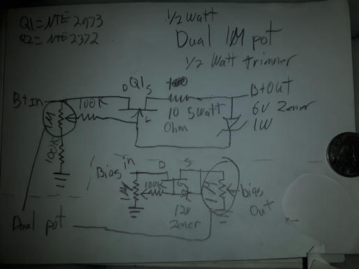

i use 1 Ohm cathode resistor, since 1ma = 1mv i can read bias current in millivolt directly.
If you want to experiment with B+ voltage you can try a VVR(variable voltage regulator)
Its a type of Power scaling.
Here is a schematic for a marshall fixed-bias type amp.
You must insulate the fet from the amp chassis.
