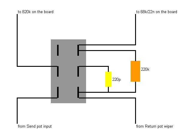

So I'll shield the wire coming from the Treble pot and going to the back of the amp to the Send part. Anything else that needs shielding after that?
I made a schematic of how I wanted to wire the DPDT switch and attached it.
Of course, I was planning a separate hole for the heaters and one for B+
Then 4 wires from pots and jacks through 1 hole and one last hole for the wire going back to the PI input.
Might be one hole too many but it fits my layout.
I was not planning on running any ground wires, as the thing is in a chassis on top of my amp chassis and the pots will be grounded there.
If Larry is okay with it, I will post some pictures after I am done.

Long return ways.franc wrote:Anything else that needs shielding after that?
Ok!franc wrote:I made a schematic of how I wanted to wire the DPDT switch and attached it.
Larry
