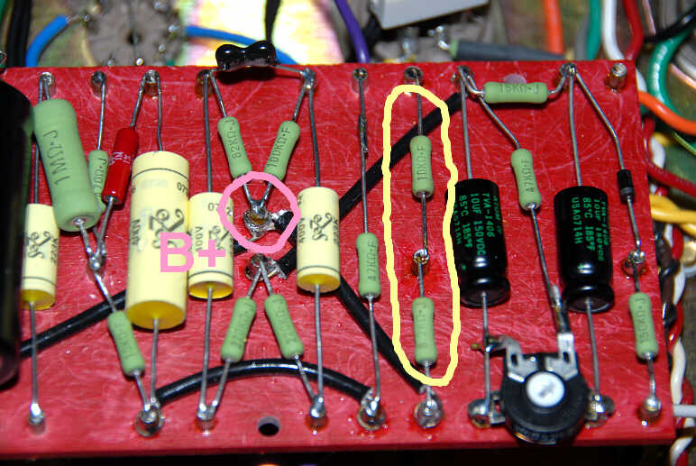

Plus, I'm having more trouble inside the amp. From what I can figure out on my own from Larry's schematic and from GeraniumBoy's post on page 11 of this thread, the B+ wire needs to connect inside the amp at the junction of the 82k and 100k resistors, as indicated in the attached photo.
[img]DSC_0065%20resize%20adj%202%20cmp.JPG[/img]
Is this correct?
Anyway, I hooked up the B+ wire underneath the board at this point and grounded the shield at a nearby post. And something is NOT right. When I turn on the amp and take it off standby, after a few moments the 10k and 8.2k resistors that are circled in yellow begin to discolor and the turret in between them begins to smoke. And when I turn off the amp and attempt to discharge the caps, my meter indicates that there isn't any charge to discharge.
Is this correct?

It's correct, where you take the B+ from.

Sounds like you have the shielded wire grounded at a wrong place. Try using the shielded wire to the B+ rail without grounding the shield itself. I have the same loop installed in my 12xxx without the shield grounded and it works perfectly and without noise. Also, make sure the wire mesh shield is NOT grounded to the wire leading to the B+ terminal. Since the resistors got hot you may need to change them.
