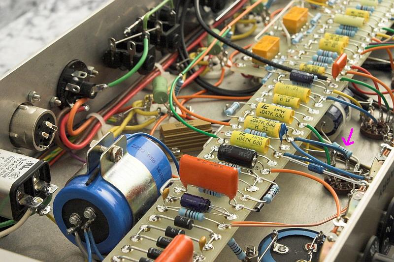

In my DINO amps I'm using even a 100K grid stopper at this spot, to obtain a slightly tone shape/highs roll off additional to the (possible) RF suppression purpose (seen on the photo below).
With lower values of grid stopper like 33K or a 47K, as Randall has suggested, you barely will hear an additional highs roll off - maybe with dog ears :lol:

novosibir wrote: In my DINO amps I'm using even a 100K grid stopper at this spot, to obtain a slightly tone shape/highs roll off additional to the (possible) RF suppression purpose (seen on the photo below).

Nice work, Larry!
RA

raiken wrote:Nice work, Larry!
RA
Thanks for your kind words, Randall!
Larry
