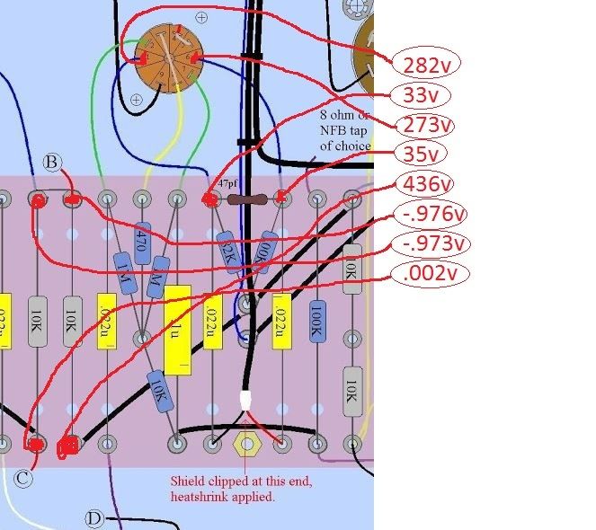

Voltages:
V3 on pin 1 i have 282vdc and at the turret of the plate resitors i have 33vdc.
V3 on pin 6 i have 373vdc and at the turret of the plate resistor i have 35vdc.
tracing back to the bottom turret of the 10k dropping (right side) is reading 436vdc, top of that 10K its reading -.976 (yes negative)
the left side 10K dropping is reading -.976v at the top and .002v at the bottom.
here is a picture:

Check and make sure that 10K/1w dropping resistor isn't an open circuit.

Problem solved! :thumbsup:
The 10K decoupling resistor failed, even after removing there was no reading from it.
