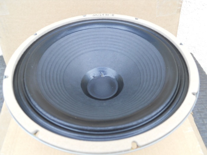

Here's a pic of what a rebuilt speaker looks like when finished, which now
has the improved smooth and dry correct doping with uniform thickness.
